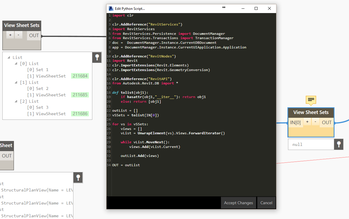

Get views from viewset?
I am trying to get all the Views in a ViewSet, but I am getting an error saying “the managed object is not valid”. I’m not sure where I am going wrong as I have written it in C# the same way and no problems. Is this a Python thing? In C# I need to cast as view although in Python this doesn’t work and no matter what I do it won’t give me access to the View properties.
I’m relatively new to Python, so still rough around the edges when it comes to syntax, but any help would be appreciated as I’m a little stumped. :slight_smile:
Cheers,
Dan
Try to use .append instead of .Add. It would be better if you pasted the code here. You can format it with the </> button.
Legend! Works a treat @Kulkul. Thanks for the very quick responses also!

@Yna_Db,
What i’m interested in is the code behind the “View Sheet Sets” node which is shown in the picture originally posted by Daniel_Woodcook. The node outputs the ViewSheetSet objects and their names.

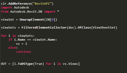

sorry I tried it but something is not right, I get a warning
Warning: IronPythonEvaluator.EvaluateIronPythonScript operation failed.
Traceback (most recent call last):
File “”, line 30, in
NameError: name ‘vs’ is not defined

viewSet = UnwrapElement(IN[0])
viewSets = FilteredElementCollector(doc).OfClass(ViewSheetSet)
for i in viewSets:
if i.Name == viewSet.Name:
vs = i
else:
continue
OUT = [i.ToDSType(True) for i in vs.Views]
