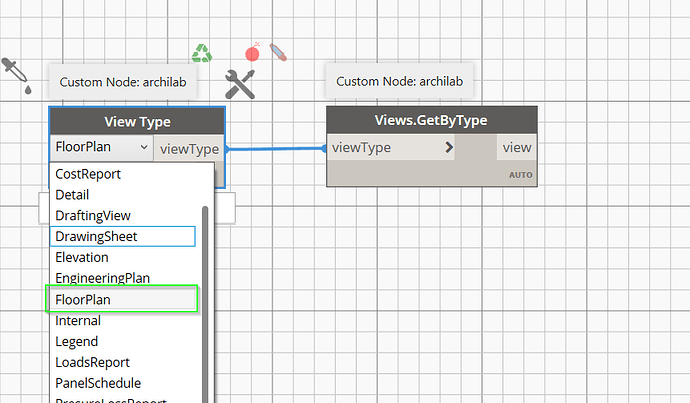

It works for one but not the other, I am trying to collect floor plan views:

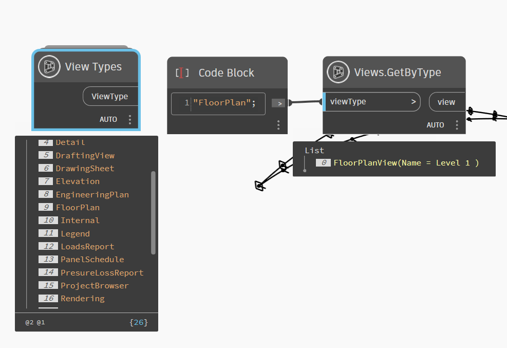

i did it this way
KR
Andreas
What does your error say?
Looks like an archilab node GetByType.
Its different naming than Revit standard.
Try FloorPlan instead of FloorPlanView.
Hope this helps.
Hi @Falk something here seems to work…

Thank you all for reply, the solution @sovitek provided was the one that did the trick.
Dunno why I didnt try that option before coming here. Anyways thank you very much. :slight_smile:
