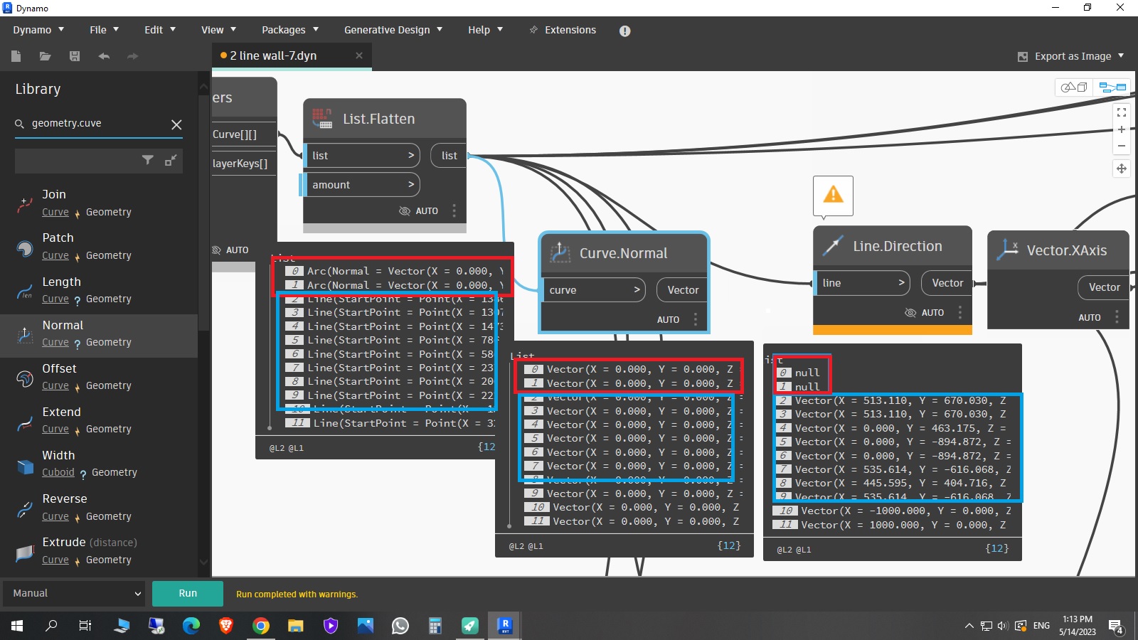

Hi …how can I get the vector of the arc

thanks, dude but it is not answered…it just returns the z value…I want some things same as line direction
hello, as much on a line your guiding coefficient is constant therefore your normal is constant, as much on an arc (the curvature exists) the guiding coefficient evolves along your arc as well as the normal it must be requested at a point for the arc
https://dictionary.dynamobim.com/#/Geometry/Curve/Action/NormalAtParameter
Cordially

Hi @ali_arch …probably something here…
thanks, alot…its work…

PS keep in mind the arcs vector will be from start -end point as the lines…the same as vector by 2 points :slight_smile: :smiley:
