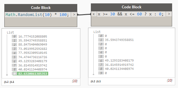

hey , i have similar question , there’s a way to match value Beethoven two numbers?
30>x>60
thx
You are absolutely right but i mentioned that i tought i could work from there…
I read a lot about the nodes and what i can do with them, the dictionary is very helpfull too but when you search for string or index you miss the replace by condition node.
thanks for your answers.
@raber95 Yes you can do that just copy paste below code in Code Block node and pass your list for X.
30<x && x<60;
You can refer to the below image as well for better understanding.
Do let me know if this doesn’t work.
an associative IF one-liner might serve you better in your example:
After all, this is exactly the use case it was modified for with the 0.8 release :slight_smile:
thx, that’s work :slight_smile:
