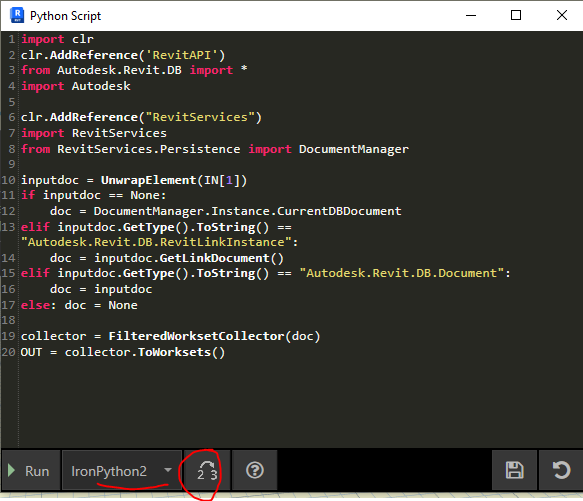

Choose the DynamoIronPython2.7 package. (This is the version installed by default in previous versions of Dynamo).
ok @Alban_de_Chasteigner
I’m feeling a bit lost with the new interface, and I’m trying to figure out this IronPython 2 or 3 this. Also, do I need to install IronPython 3?

The release notes and this blog post might help: Dynamo Core 2.13 Release - Part 3/3 - Dynamo BIM
