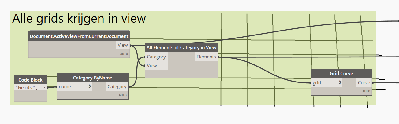

I would like to get the properties and grid.curves of the specific curve in the view (changed)
But I get the grid curves of the full project.
How can I fix it?
Thanks in advance!!

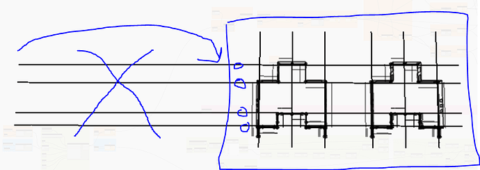

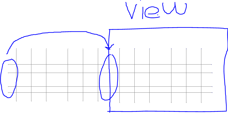

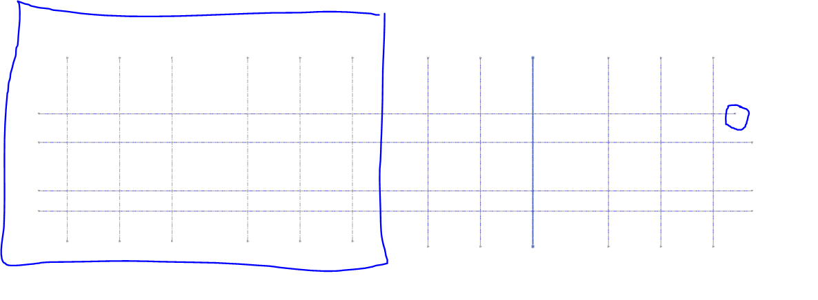

But in my full project the horizontal grids are a lot wider than the view with the scope box.
Total project Grids
So I need this properties and curves (Grid Curves of specific view part)
View Grids

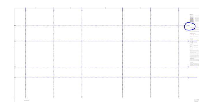

I have the 3D grids (1st picture) and another view (2 picture) with 2D extents or trims.
I want the lengte or properties (curves) of the 2D extended /trim Grids (not of the 3D grids)
