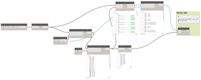

Basicly I want to get a nice list of all the panels (panel families which are windows / doors) of a list of curtain walls I have.
SInce I can’t ??? I tried the other way, selecting families, get their parameter ‘host id’ … which is a wall. Get “Mark” from those walls.
Now comes the tricky part, I want to filter the families based upon the Mark value from the walls.
So curtain wall (Mark “A”) has 3 windows (1m2, 2m2, 3m2)
Selecting all windows gives a list of 3 windows,
getting host id gives wall with id ‘xxxx’.
getting Mark from wall gives ‘A’.
Now I want a list that says A[1m2,2m2,3m2]
And yes obv. there are many curtain walls, many windows. So that’s why I thought the other way around would be MUCH easier … select curtain walls, get elemets, get area. done. …
What am I missing?

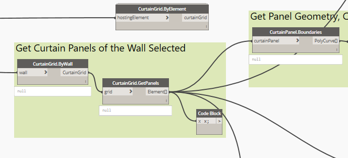

check out the Wombat package, there are some good nodes CurtainGrid.ByWall and CurtainGrid.GetPanels with those two you should be able to access the windows.
Wombat-Nodes
