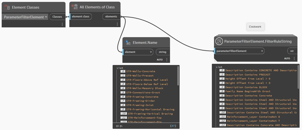

You can get the Filter Rule String with a clockwork node - like this
If you require a breakdown of the rule I would crack open the clockwork node and change it to return a list rather than a string
Thanks a lot @Mike.Buttery
It is what I was looking for.
I will look into this python code and reformat for my need.

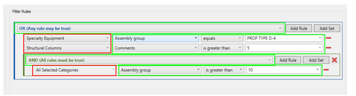

FilterRuleString from Clockwork node get everything from highlighted in green.

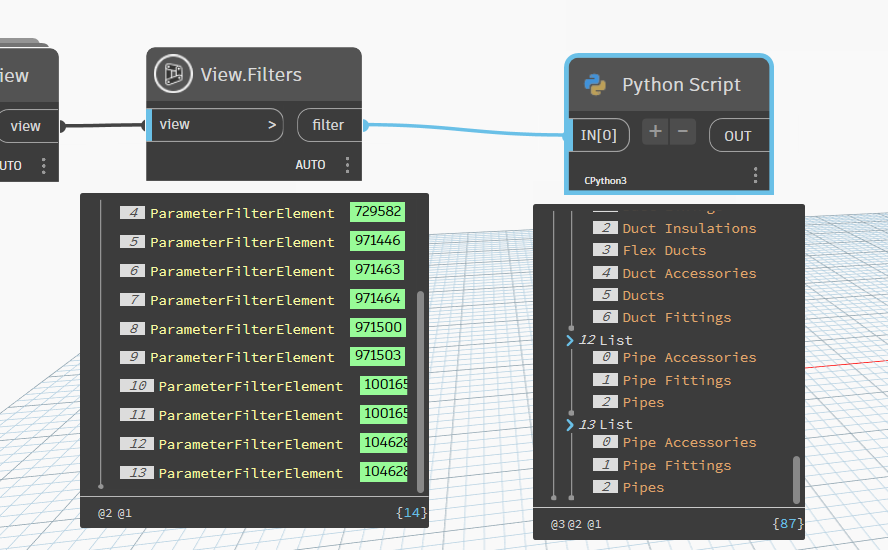

This topic provide a python script to get categories for each parameterFilterElement.
Is there a way to get also what is highlighted in Red (the categories for each rules)?

The ParameterFilterElement.GetCategories() method returns a list of category ids, from there you can get the names like this
# For single ParameterFilterElement
pfe = UnwrapElement(IN[0])
cats =pfe.GetCategories()
cat_names = [Category.GetCategory(doc, cat_id).Name for cat_id in cats]
Hi @sovitek,
your script ouput the categories applied to this filter, meaning if the rule is set to “All selected categories”.
I’m looking if the rule is set to a specific category.
The individual categories of a filter are available from each element filter and only if the logical filter is an ‘or’ filter. It gets a little inception-y with lots of layers, thankfully when you get to the third layer it doesn’t take 8000 times longer
ParameterFilterElement.GetElementFilter()
├─ LogicalOrFilter.GetFilters()
|  ├─ ElementParameterFilter().GetRules() <- If this uses all categories there will
|  |  |                                      not be any FilterCategoryRule elements
|  |  └─ FilterCategoryRule.GetCategories()
|  |     └─ Doors                         <- Individual category
|  |     └─ Walls
etc...
