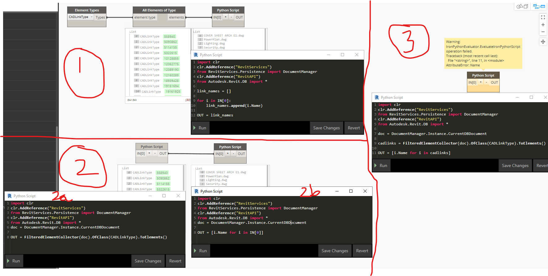

I am attempting to extract the CADLink Name from an import instance, I’m working on this now to then merge it into another Python node. I’ve found a way to get the CadLink type from an import instance, and I’ve gotten the name from a cad link type in separate python nodes, but when I combine the two into methods, I run into this error. Let me know if more information is needed.
Thanks,
ele isn’t a list so you can’t loop it.
names.append(ele.Name)
It works in Case-1.
It works in Case-2 when you get elements in 2a and supply it to 2b
But it fails in Case-3 when you combine 2b and 2b in a single script.
Is this the problem @patrick_podeyn?
Yes, that is the problem. They work separately and connected together, but when you do it as one python node I can’t figure out why it doesn’t work.
