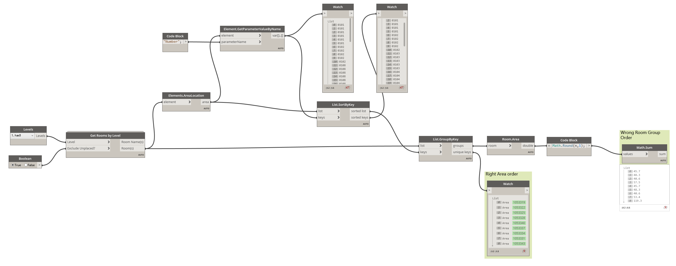

One last thing. I was able to sort Areas by Number parameter with @lucamanzoni script but I’m not so sure I have the solution in yours.
I really have to get that right if I want the information to stack up in right order.
Cheers!
I was able to sort the Areas by Number parameter but my Room Area sum up doesn’t sort up in right order.
Rooms_Areas
