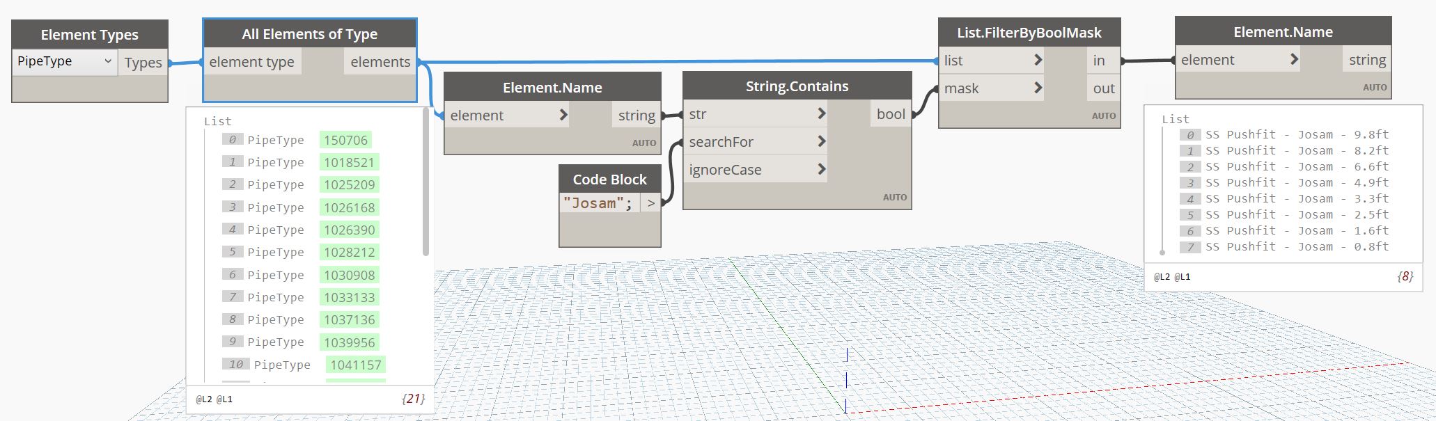

Get all pipe by type?
I want to select all pipes of type.
I know I can select all pipes in view/project and filter byu type but I sometimes have A LOT of pipe and though that this would be faster.
Not sure if it’s a question or a solution you found.

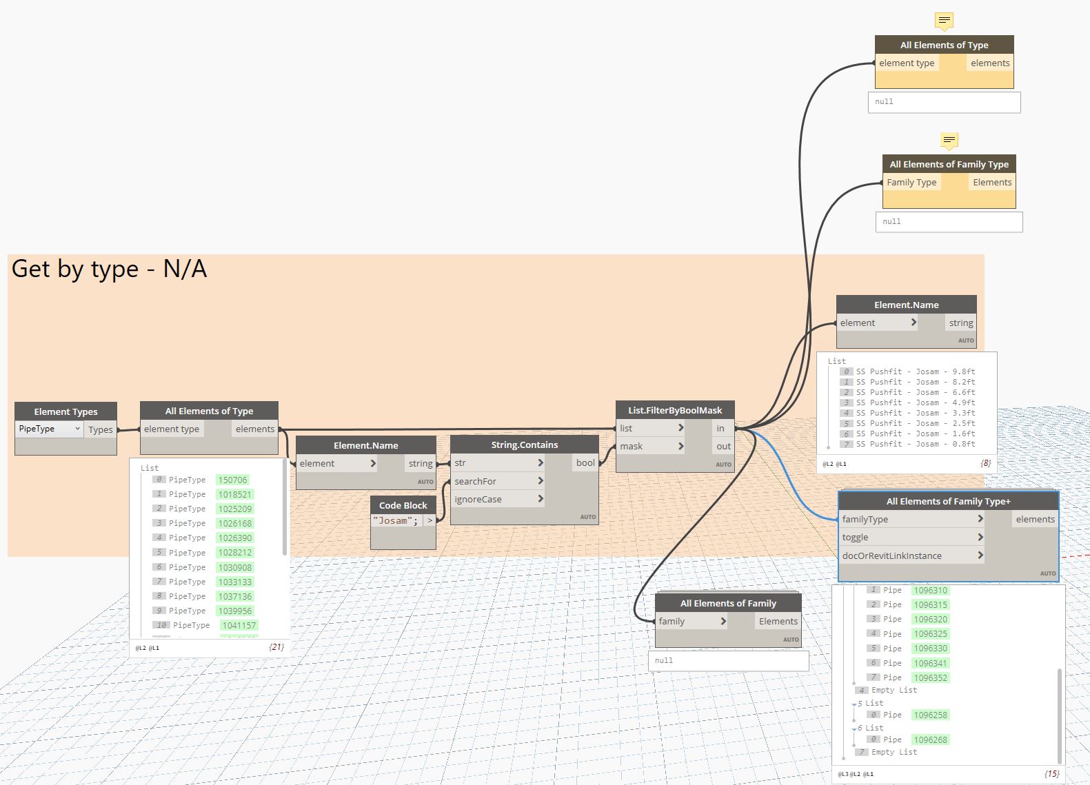

The only thing you’re missing after the boolmask (so not the Element.Name) is an All Elements of Family Type Node (OOTB) or the all Elements of Family Type+ Node (from the Clockwork package)
The last one also support linked elements and supports more elementtypes.
Pipe type are weird and don’t act like regular types.
Elements of Family Type+ Node (from the Clockwork package) worked though thanks!
