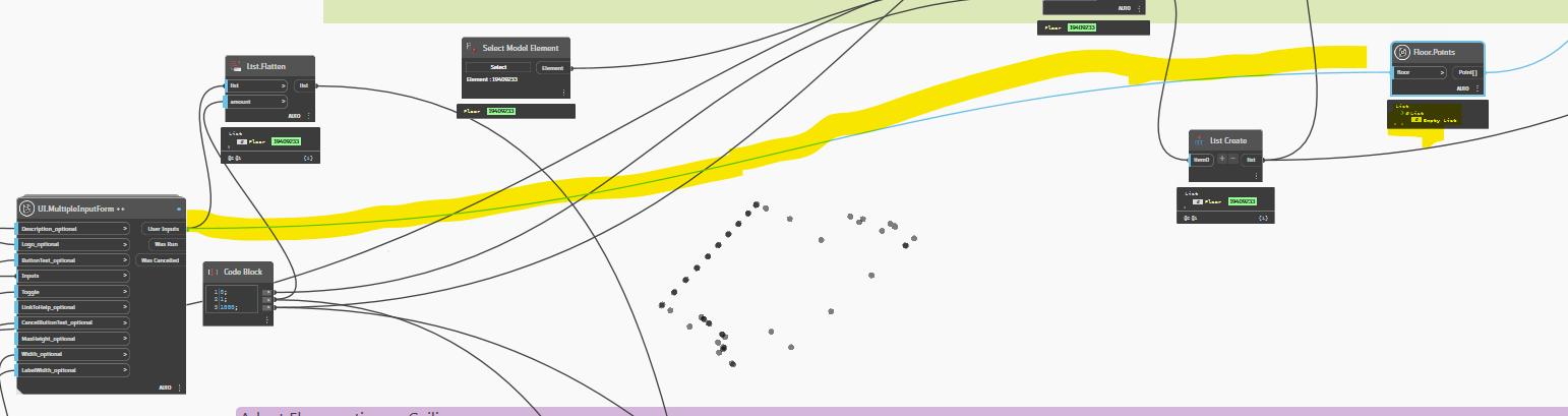

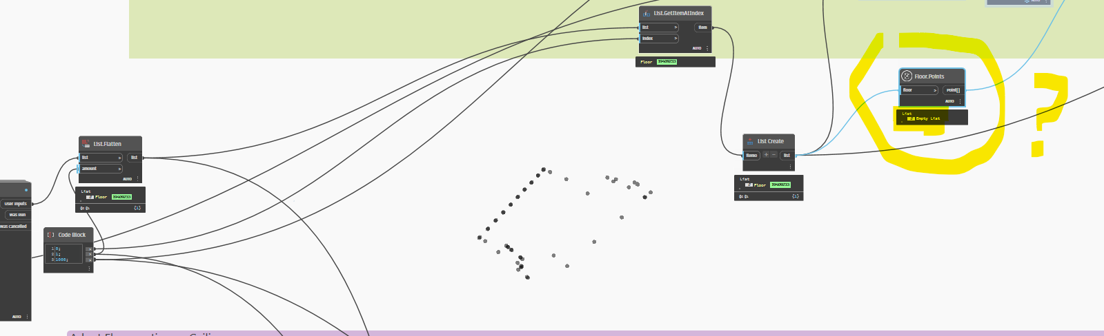

Floor points not working. Why not. Script worked fine last week!
Hi @Gcf_Design does it work without list create first ? or some lacing
allright im not at dyn right now…but if i remember that node sometimes fail, and sometimes work for me with disconnect- run, connect again and run…but not sure in your case
I shall try
No joy. Ridiculous, because it’s worked fine for a long time and earlier today it worked and not it does not.
I have restarted both Revit and even the PC, no joy.
hmmm yeah, just a shot have tried replace the node with a fresh one…ps guess clockwork have one as well you could try…
I have tried a fresh one. I cannot find the equivalent node in Clockwork?
yeah probably i remember wrong
another one sometimes
copy all nodes to a new dyn and try again…but absolutely not sure here…
I shall try that
Sadly no. ![]()
Guessing it’s an issue with the model.
Start a new model with a new floor and recreate the issue with a new floor and a simple .dyn (Select Model Element > Floor.Points node ). If you can’t do so look at what differs between the floor in your failing project and this one. If you can recreate it post that file and the simple .dyn.
If you can’t identify it there then remove everything except the one failing floor (all views but one 3d view, all levels but the host, all model elements, all textures, etc.) and post that and the simple .dyn.
I shall look into that and get back on here.
