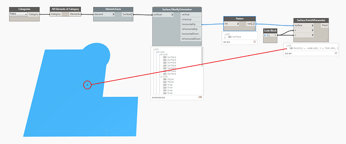

In that case drop your dummy rvt file showing Floors/Slabs.

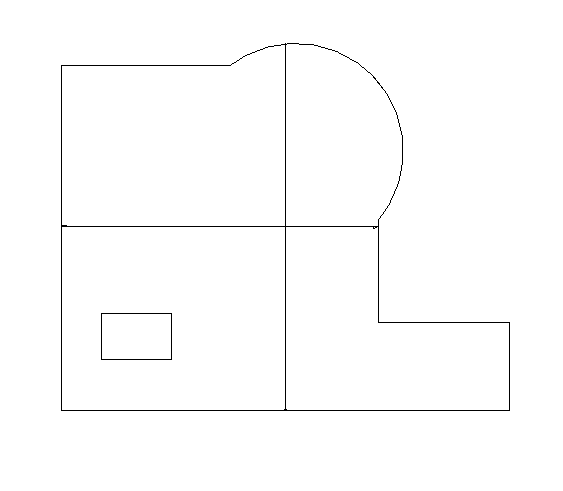

I am studying duplicated element case, so any shape of floor I want to be able to get the mid point. for eg. as the picture below

Thank you @Kulkul
