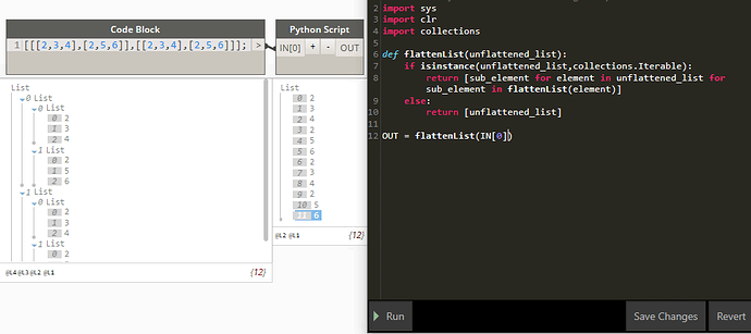

Ages ago I got this code from this forum and it’s always worked well.
It still works well with numbers but if I feed it stings it crashes.
Any idea why?
import sys
import collections
def flattenList(unflattened_list):
    if isinstance(unflattened_list,collections.Iterable):
        return [sub_element for element in unflattened_list for sub_element in flattenList(element)]
    else:
        return [unflattened_list]
OUT = flattenList(IN[0])

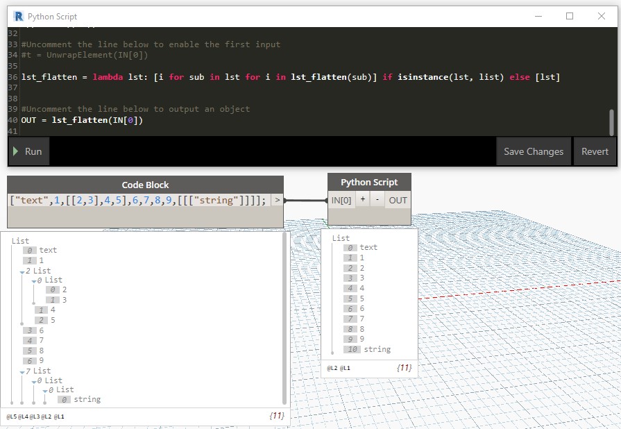

It’s a recursive function and it goes recursively every time the statement if isinstance(unflattened_list,collections.Iterable) is true. This will always be true for strings since they are iterable unlike integers. So try changing this statement for something like:
if isinstance(unflattened_list,collections.Iterable) and not isinstance(unflattened_list,str):
it is also possible to avoid the use of the collections method, this way you’re safe every time you flat a list:
lst_flatten = lambda lst: [i for sub in lst for i in lst_flatten(sub)] if isinstance(lst, list) else [lst]
