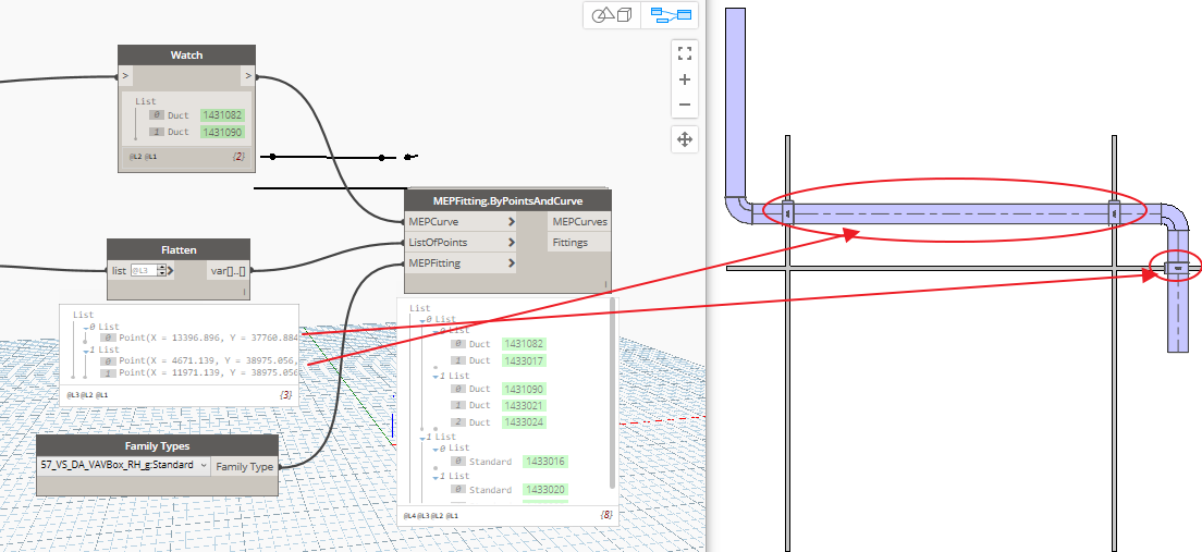

Did it work perfectly if one duct element is intersecting with multiple fire rated walls?
I’m having difficulty to make it work in that scenario. It puts a fire damper but It breaks my duct element connections. so its no longer in one HVAC system.

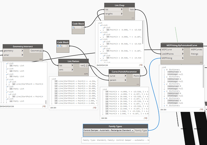

For me it didn,'t work at all. MEPover node returns null result and all other nodes work fine.

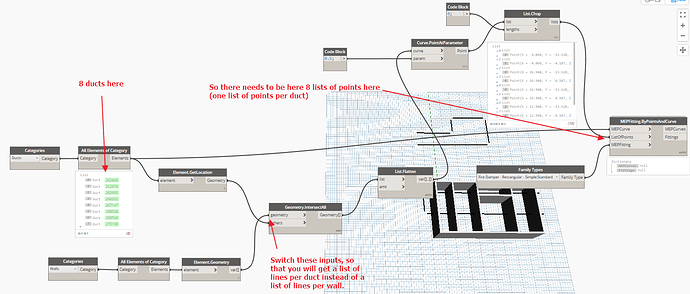

So I had a look at Simo’s Revit and Dynamo files. There’s a few things that I’d like to highlight:
  • Per duct you need to supply a list of points, even if it is just a single point, then it has to a list of one point
  • Make sure the points are on the duct location lines
I have modified the dynamo file to make it work. The above two points were not in order so that’s why it did not work.
Fire Damper Autoplace.dyn (25.0 KB)
Thanks so much it worked
Hi @T_Pover ,
In my case, here is the example where the node works and where doesn’t. if one duct element is crossing multiple fire rated wall it doesn’t work. Does it work at your end?
Works on my end, here are the inputs to the node:

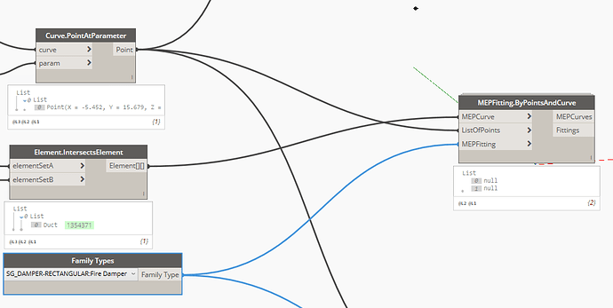

Hi Everyone
hearwith I attached dyn file
the problem is I cannot find every duct across every wall intersection point
please helpplacing fire damper(2).dyn (42.8 KB)
