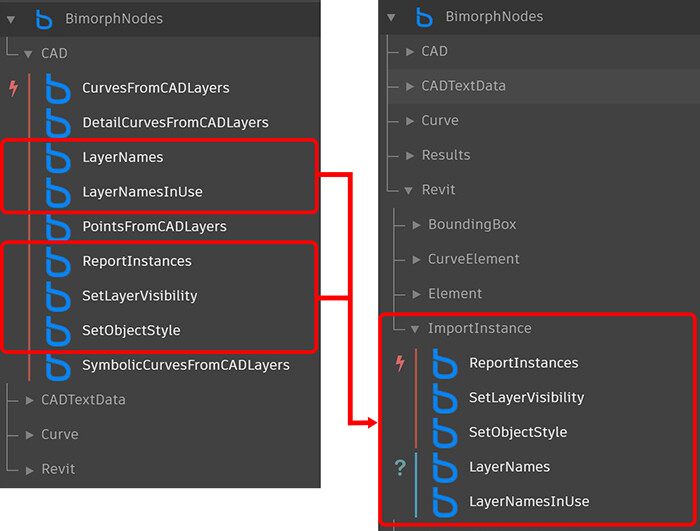

i am trying to find the reference view for each linked dwg in our project, previously i have used a node from Bimorphnodes " Cad.ReportInstance" wich worked pretty well, now they have updated the nodes adn there is a new way to do that, i have tried it, but im not getting what i am wishing for, can someone help me, what am i missing here?
Hi @yazanhijazeen32 its still in the latest package, its just been moved to the new ImportInstance node class. Full details of what’s changed is detailed here.
Old:

Yep just use the new query nodes from the report to get the reference view; use the ImportInstanceReport.OwnerView node:
