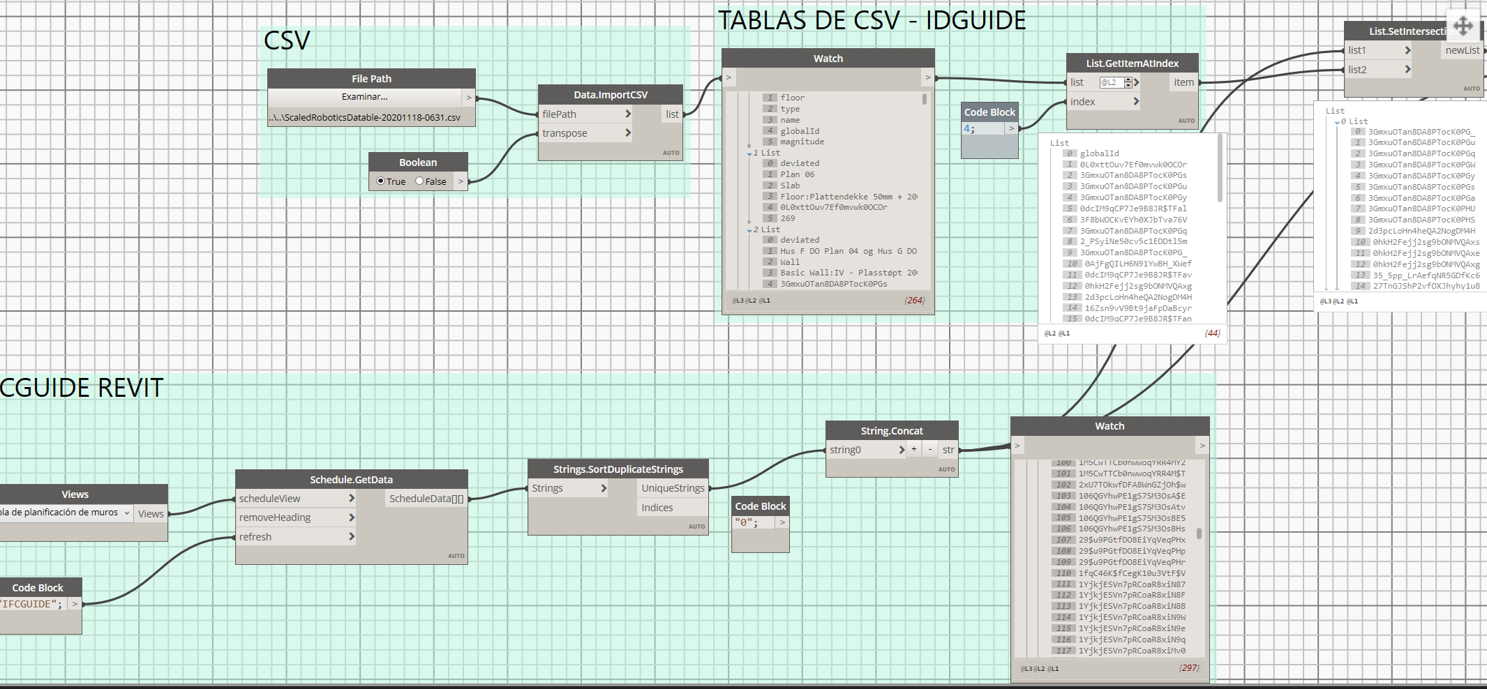

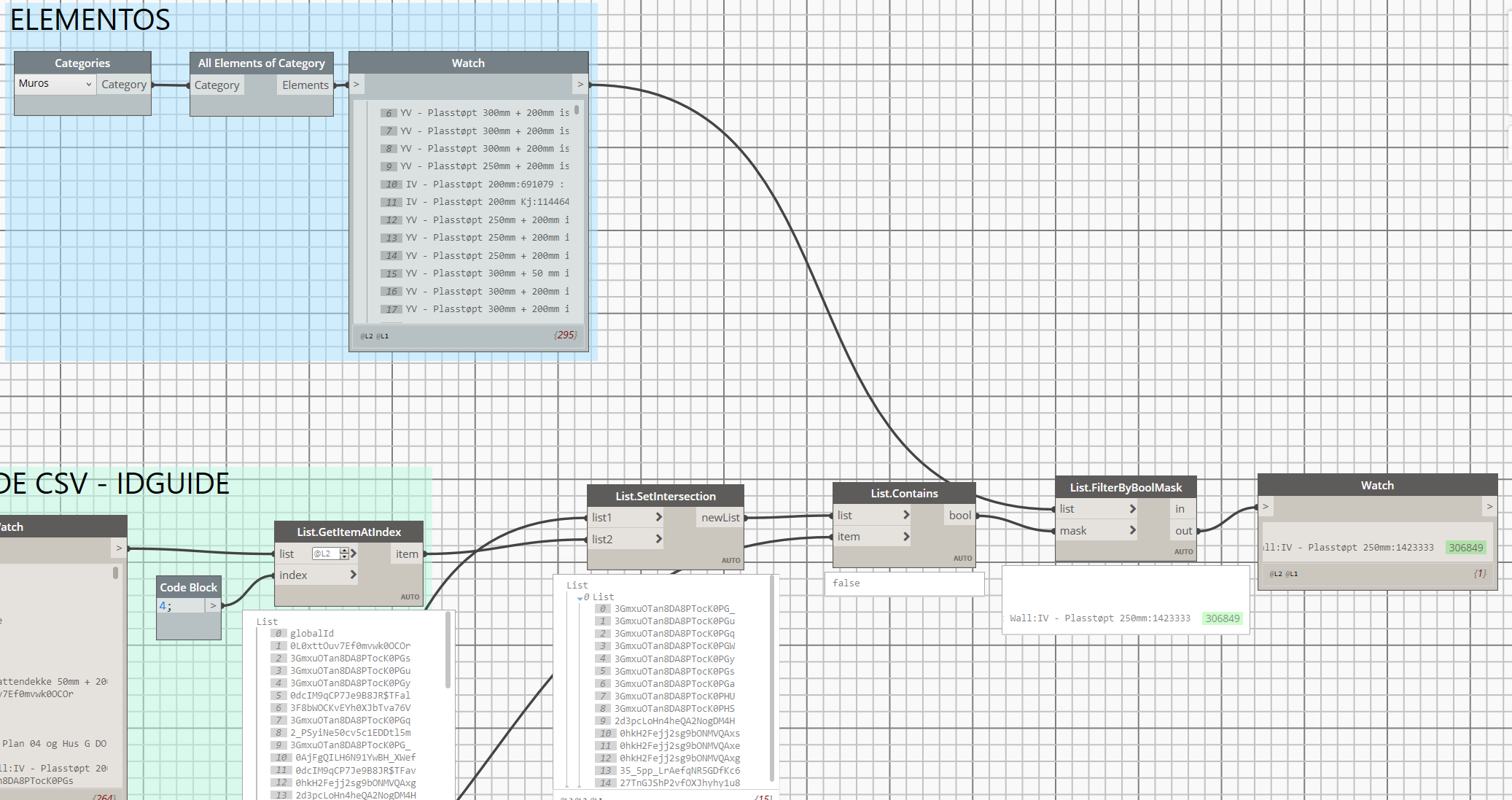

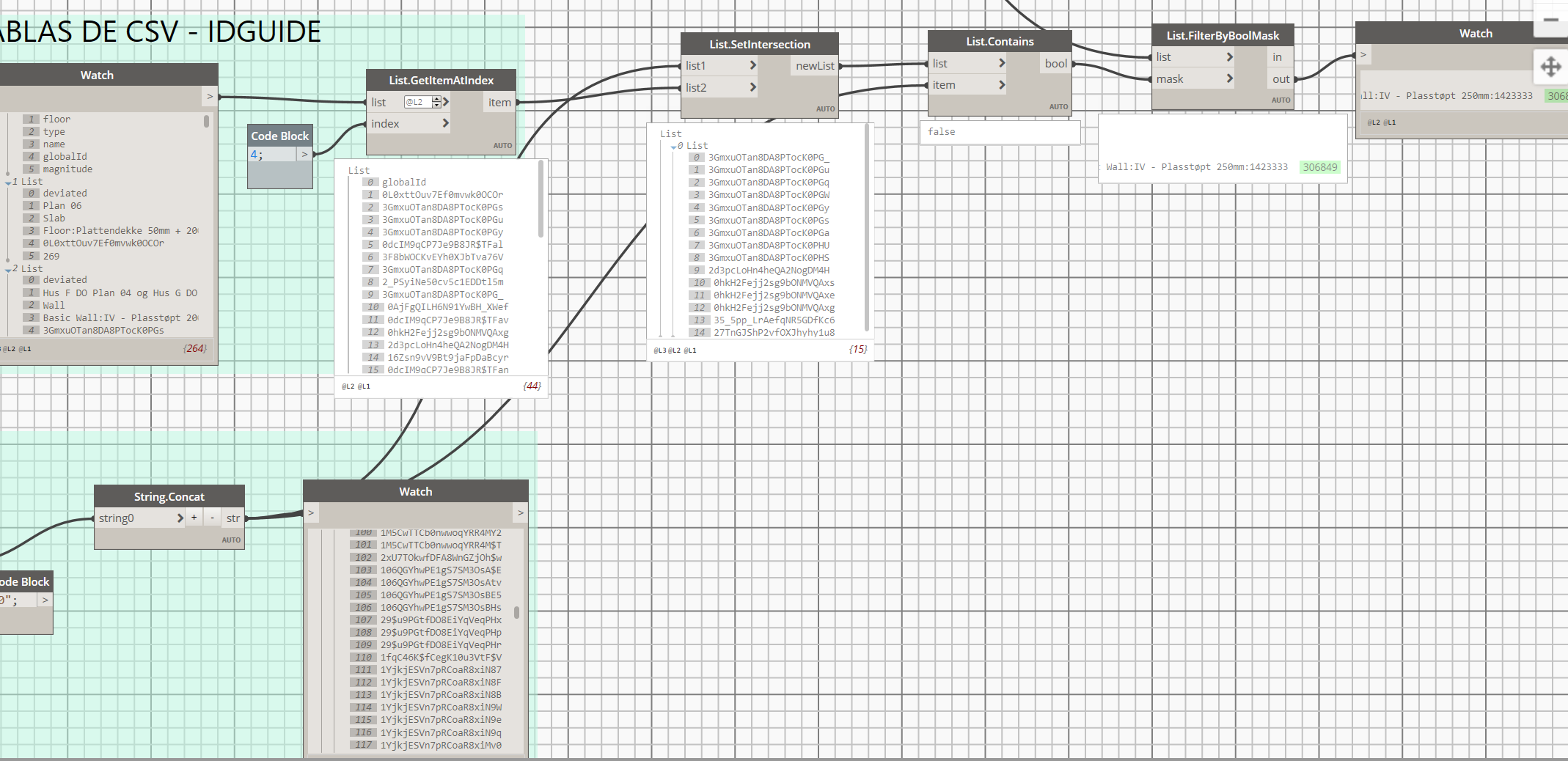

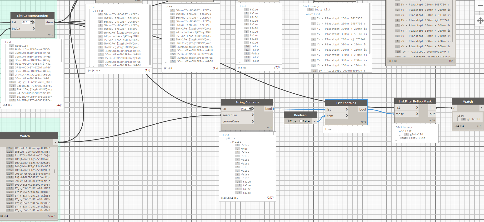

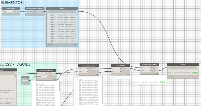

Hello everyone, i need help…i need to find the elements on revit that are associated with the ifcguide … they should be 44… i try the option list filterbyboolmask but as shown it is only showing me one element… any suggestion ?
Maybe use Flatten
after List.SetIntersection

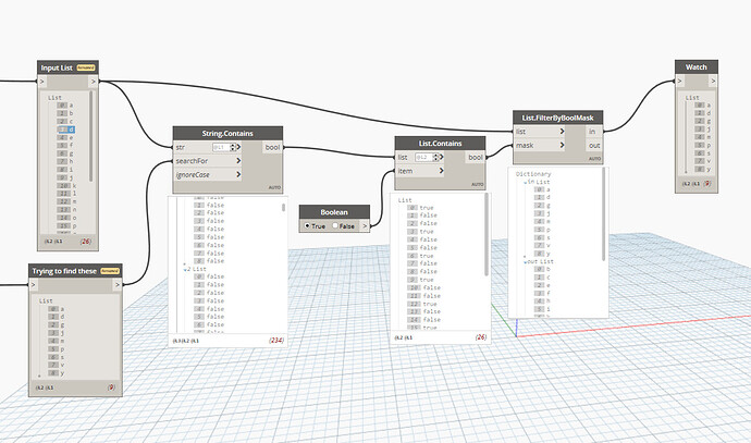

Your list contains does not have a list level for the incoming list.
