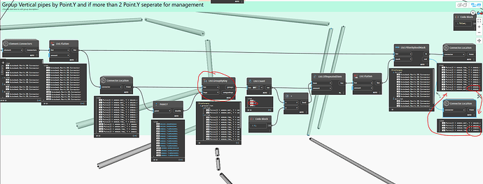

Anyone that cant give me some advice how to keep list structure and sorting, see image below.

Can you explain what you’re actually trying to do here? Your first image is illegible and it’s a little confusing. List structure and sorting won’t change unless you do something to change it.

Sorry that the picture is not fully legible, I initially thought that it did not need to be shown as the question was only about how I should be able to preserve the structure.
Just as you write, the structure of the list has been changed, now I want to try to recover the structure of the rest of the nodes in the port out.
As you can see from the Image from first post (I filter out everything except 2 points that I process for creating Tee. The out port I deal with vertical pipes that dont have horizontal pipes, these other gaps might have had a valve of some sort that need to be handled)
Picture below does not work properly, because of the other issue that I ran into when adding one more pipe branch as mentiond below.
Now I want to see if it is possible to recover the other nodes in the OUT and keep the same structure without having to do the same processing again, which feels unnecessary if there is a better way to divide what should go to port IN and port OUT.

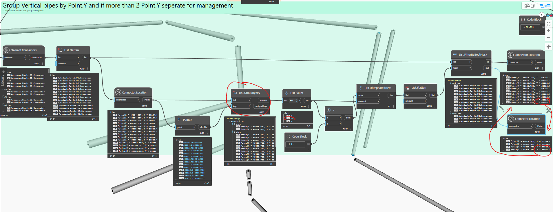

Picture number 2 wich I updated in this post.
Before I flatten the list, the information comes from MepOver’s Element.Connectors.
I use List.GroupByFunction to group all y-axes, which appears in the image, all values ​​are grouped correctly.
But if you look at the final product, I have 10 nodes out, but they are not the nodes that were grouped in List.GroupByFunction.
What I do know is that I created another pipe branch in the picture below labeled 2, when I only had pipe branch labeled 1 there were no problems with the end result.

Correct me if I’m wrong. Can’t you just… hit “use levels” and “keep list structure” on boolMask “list” input?
Can’t test rn but could have sworn I have used it before for advanced filtering.
EDIT:
Tested - you absolutely can:
Great, I’ll try it later and mark this as answer
As I mentioned earlier, structure and sorting only change if you do something to change them, which you did. When you group the connector locations based on the Y coordinate you’ve restructured your data. The list of grouped points no longer matches the list of connectors.
You’re probably better off restructuring the connectors to match your data. You can use GroupByKey instead of GroupByFunction to group the connectors based on their Y coordinates (keys). Then you’ll be dealing with the connectors directly.

Super Thanks @1bitBoolean !
This is the end result, exacly what I wanted!!
Now I can continue with OUT nodes in the same exacly like they came in.
Hi again @Nick_Boyts,
I change to GroupByKey but the same result remains, even closed down dynamo and revit between dynamo runs to see result, its the same.
If I remove the upper pipebranch everything work great. But when I add it again the “error occur”.
You want to group the connectors not the points. Then you’ll be dealing with the connectors themselves and won’t have to worry about matching the original list structure. You still use the connector location and Y coordinate as the key to group by, but you feed the list of connectors.
Hi @Nick_Boyts,
You are of course right, why didn’t I see this….
I knew it all along but wanted to check if you saw the error :wink:
I even added a 3 pipe branch and it works great.
