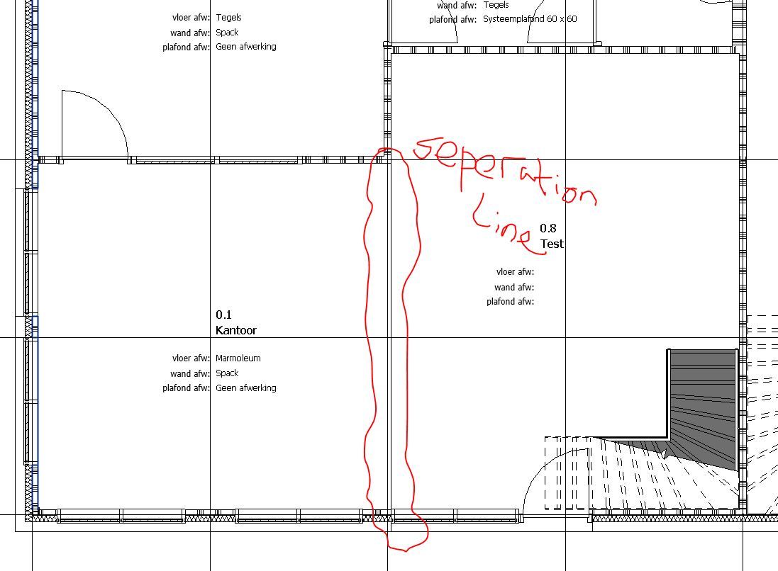

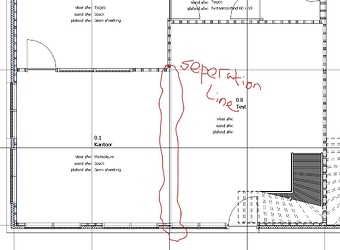

But I a little problem at the moment. When i have two rooms with no wall between it, than I wan’t also no wall between it. But with the script i’m using right now, he will create a wall finish.

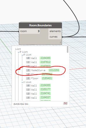

Could anyone tell or help me how i could filter out the seperation line (model curve).

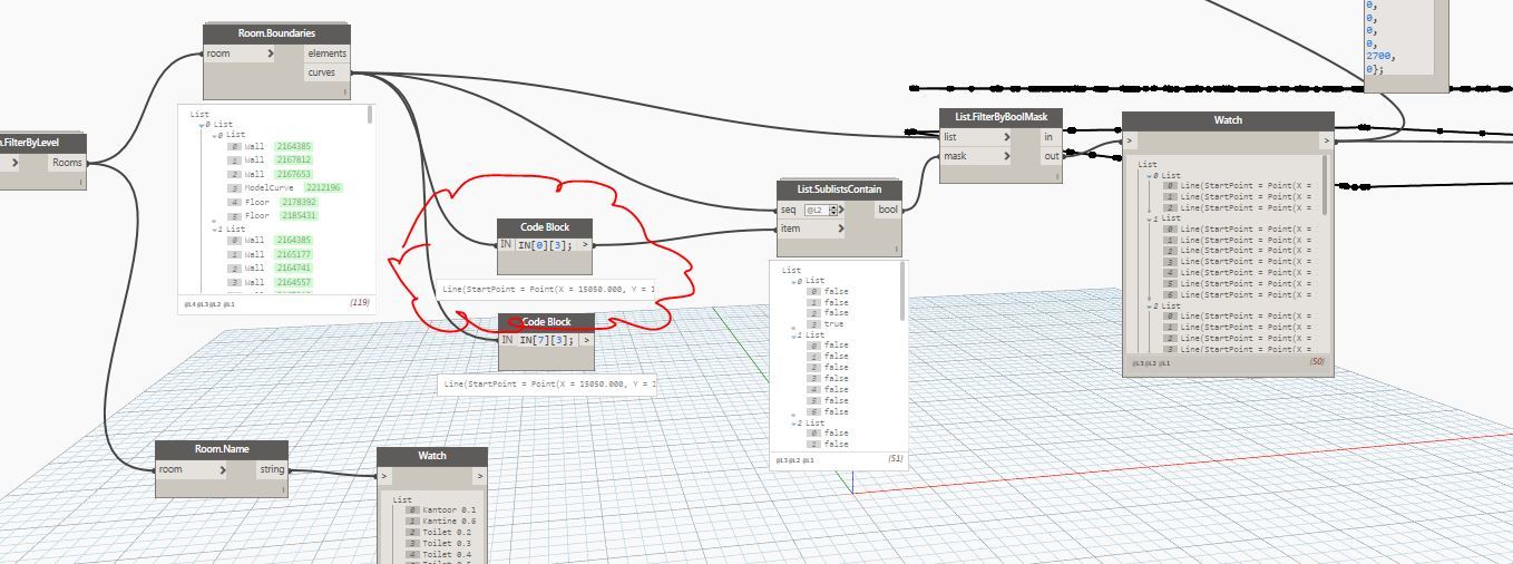

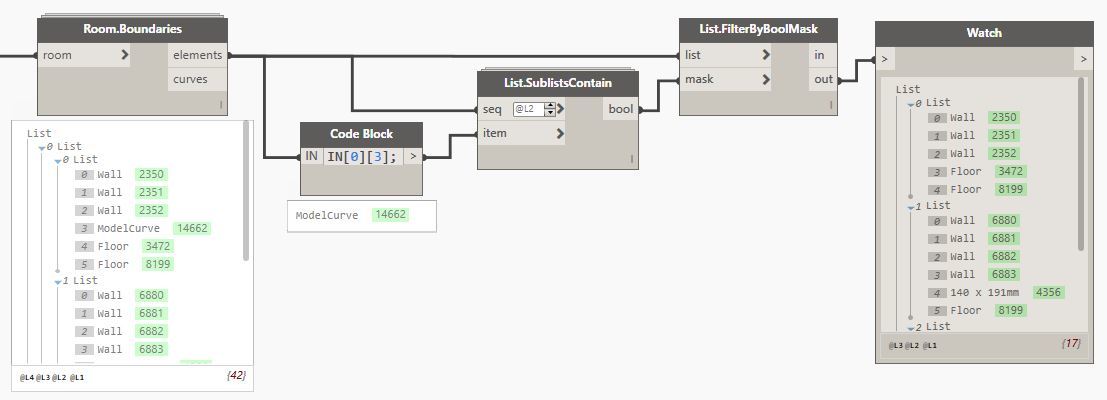

And if i have more than one model curve, I can add them in the code block?
But i have always to ride write them? I could not filter them automaticly out?
Because if I have another protject, I have to write the code block again?

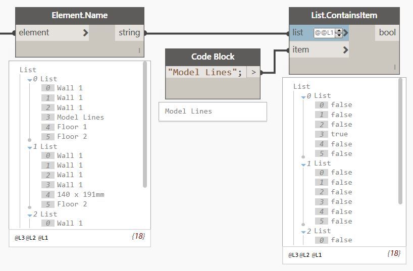

I have changed the list.sublistscontain, I have changed the input item in input list
Now he won’t create a wallfinish on the room seperation line. but now he gif warnings. ;(
I have found the solution
But have also a few problems
One problem is that you have to type each line separately, so if you want to filter out a lot of line’s you have a lot of code blocks, for each line one.

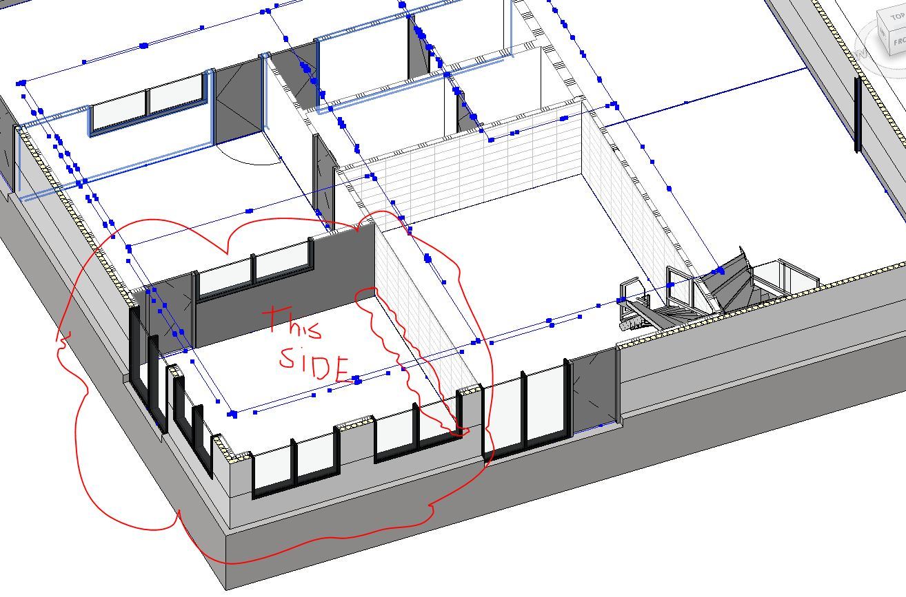

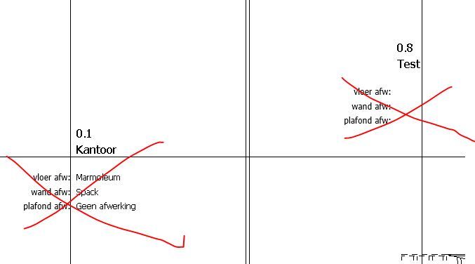

And one of problems is that he won’t joint all the wall. Sometime is have to join wall in revit in front of a window. If you know what i mean. I don’t know why he’s doing that. because with another window, from the same family it won’t happen.
