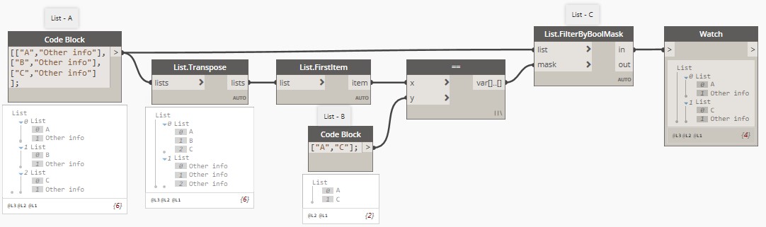

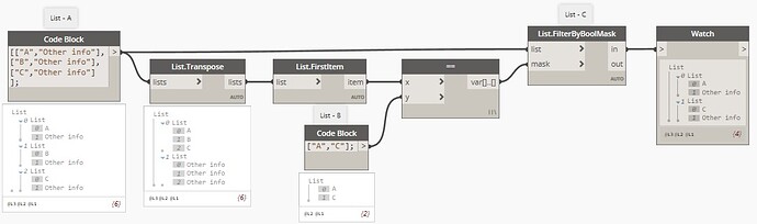

Hi @TheMattatonAP ,
Like this?

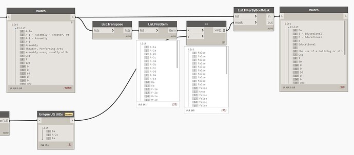

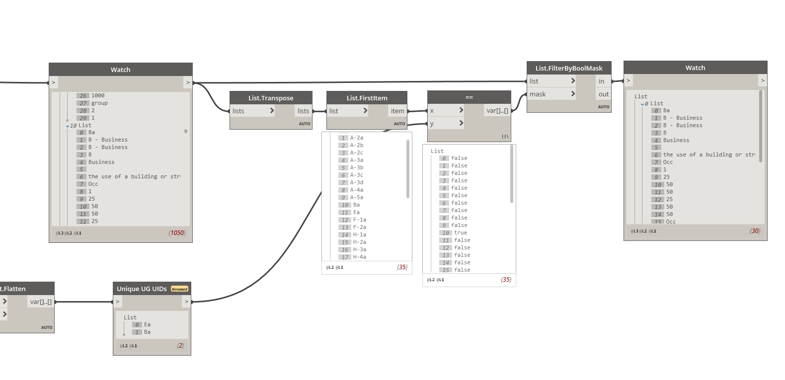

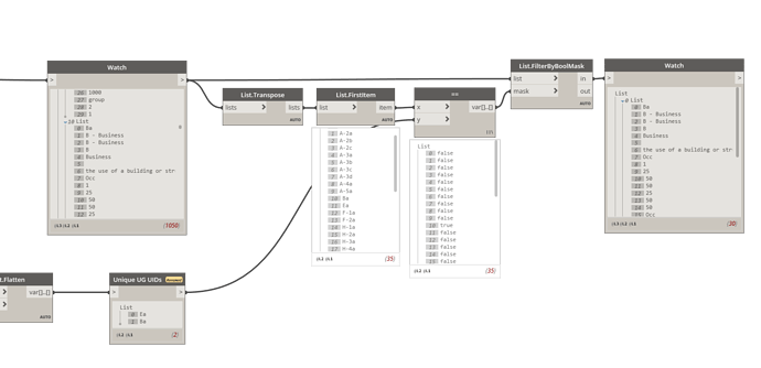

Yes, that looks just like it should work, but I’m only getting a match on the second item in list B for some reason. I have longest lacing set up on the == as you do. I don’t get why it’s not matching. Index 11 should be true.
@EdsonMatt
Second Test with more items in list B in a different order. Always uses the last item. 3, 10, and 11 should be true.
If I do a simple test with mock lists like your example with the same list structures, it works. This makes no sense to me.

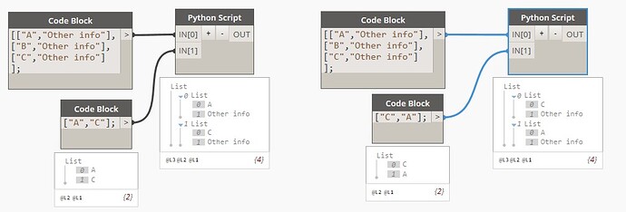

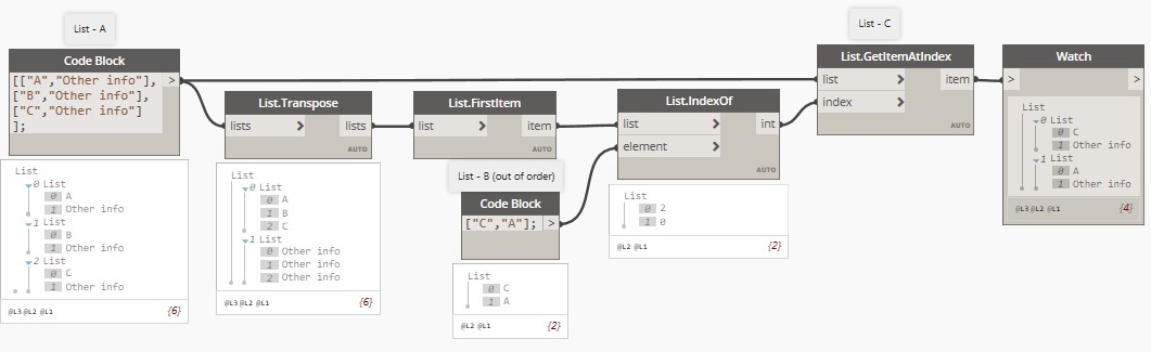

I think it’s because the order of the elements in list B doesn’t match with the order of elements in list A. Assuming the values in list B are unique in list A as well, you can try “List.IndexOf”. If it’s not, try to use “AllIndicesOf” instead of “List.IndexOf”. Make these changes and see if it works.
Here’s another approach using python, in case you’re interested in:
listA  = IN[0]
listB  = IN[1]
listC  = []
for itemB in listB:
	for sublist in listA:
		if itemB in sublist:
			listC.append(sublist)
OUT = listC
That worked! Thanks!
