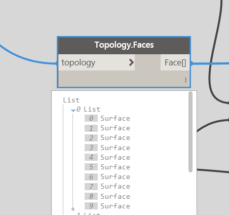

I’m trying to find the horizontal face(s) of an element.
Or better yet, the horizontal face which lies on a certain z coordinate
Is there an easy way of doing this ?
I think I need some sort of check of the face’s z coordinates.
Hi everyone,
You could use Surface.FilterByOrientation from Clockwork for this, and then use the Z value of any points on the surface with Surface.PointAtParameter and Point.Z…
