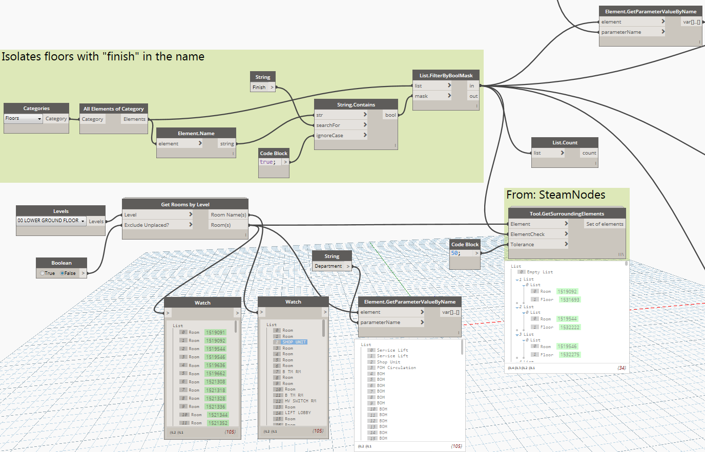

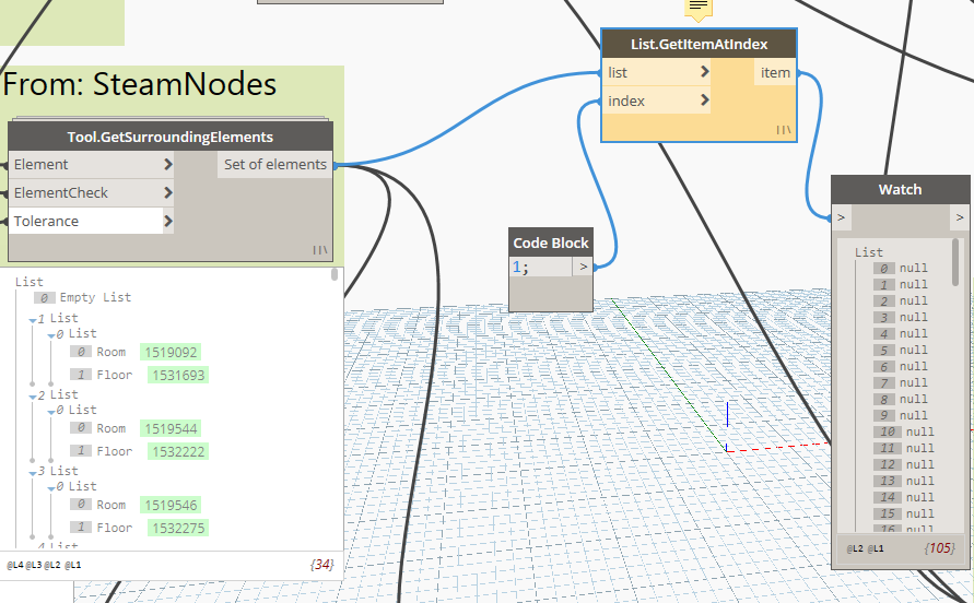

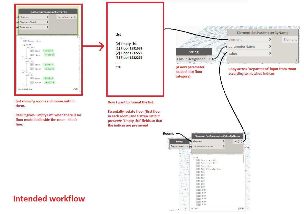

I have a nested list of lists which shows rooms and which floors are inside them. However I can’t seem to work out how to convert that list so that it only shows floors whilst preserving the indices (images below should explain more):
This demonstrates the intended purpose/workflow thereafter:
Hi erfajo, cheers for the input. As you highlighted the index method fails when trying to preserve null fields:
Yes, I reckon this should get me there provided I can use the ‘empty’ entries in the original list as a Boolean mask on the list of all rooms. That way the indices for my rooms and floors will match up. Cheers
