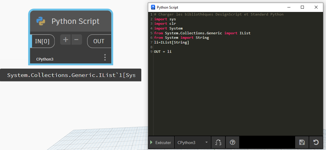

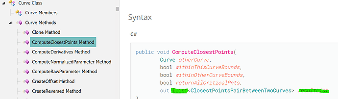

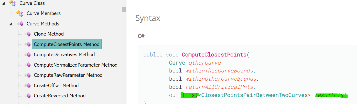

I’m trying to find out if it’s possible to feed an Ilist (it seems to have a class in System.Collection and also in System.Collection.Generic)
under CPython
is this already really an IList my starting point or not?
import sys
import System
from System.Collections.Generic import IList
from System import String
li=IList[String]
OUT = li
thanks in advance
cordially
christian.stan

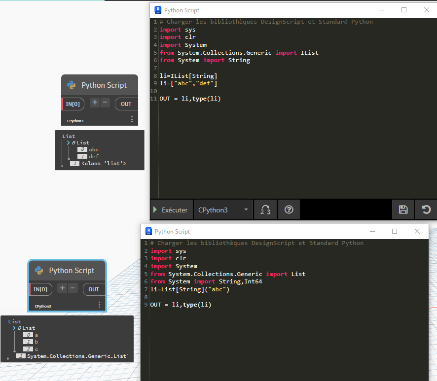

Yes - it’s a C# IList.
Try adding a few strings to the list to see the change in result. Typically the Dynamo engine converts these (and most enumerable collections) to lists automatically.

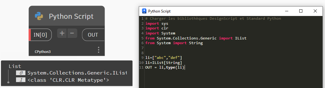

hi, thank you for answering, but by doing this I lose the status of Ilist (I don’t really know, I admit that it’s very nebulous for me, maybe I should see that later in my progression)
edit: as I use the same variable that comes after it is normal that he qualifies it as List
with Add,Append, I only have errors
Must be doing it wrong given the methods (on the .Net)

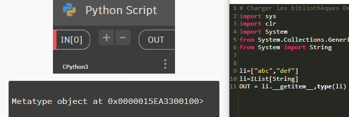

in reverse order i have this
last edit
and if I do a getitem I get a block (which goes I don’t know where)

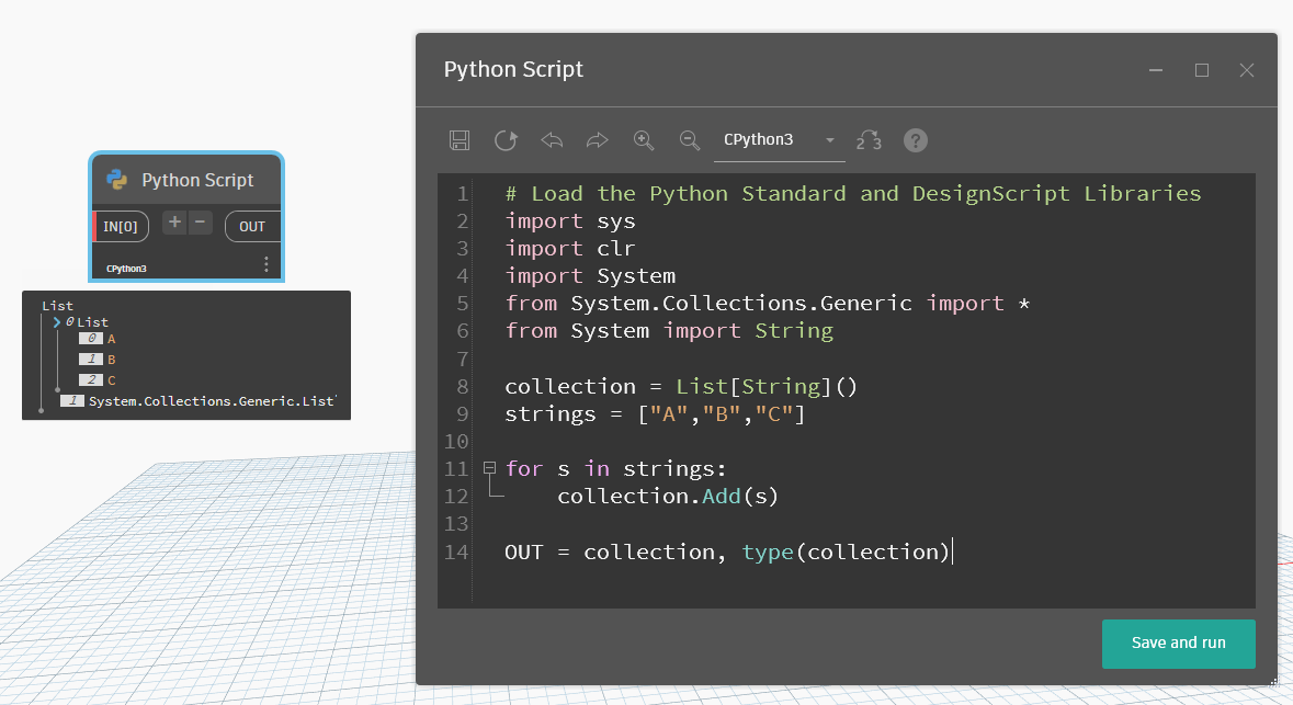

In python, an ICollection is just a List with a specified type.
The problem with most of your attempts come from redefining the collection by setting it equal to a new list of values. You either need to supply the list on creation (like you do on your third example) or Add the values to the existing collection.
