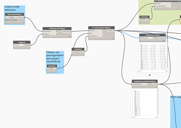

I’m selecting families from a linked model, but when I want to get the Orientation, It’s giving me a null.
Anyone knows why?

This is the node itself.
The node worked before with this setup, so I don’t understand it.

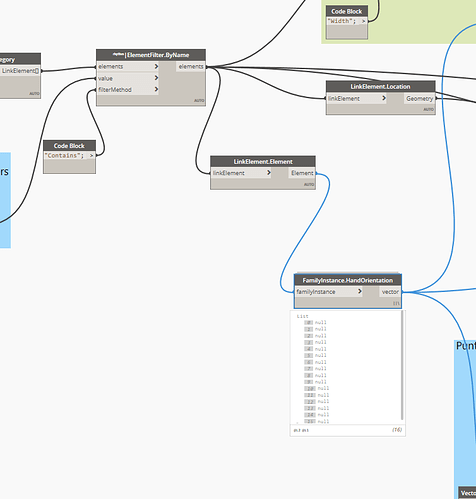

Use LinkElement.Element node from BiMorphNodes Package.
But how can I filter after this node?
You have linked elements in filter node. Take those elements to that node I mentioned to transform them. Then you can call their parameter.
Well, now I’m getting this error. The location is an error and the orientation a null.
Try using Element.Location instead of LinkedElement because you call them in Dynamo as normal elements. For Hand orientation try to use levels or lacing longest.
Thanks, that did the trick partially. It get’s a list, but with a null value.
