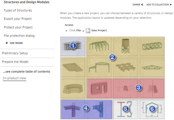

What type of project are u running?
structures
I always use ‘shell design’
could that be your problem?
Thank you for the tip.
I also realize the structure type is the culprit.
