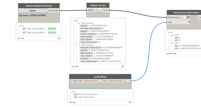

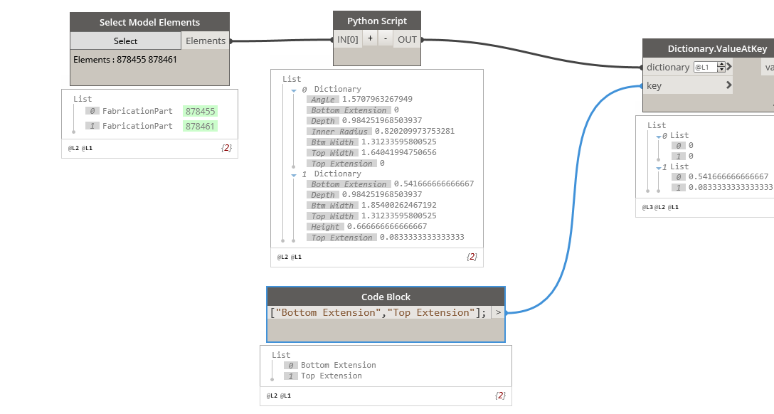

is it possible to access Top and Bottom extensions by API?
@shibujoseukken Yes, it is possible to access them by API.
Try this GetFabricationDimensionValues.dyn (6.7 KB)
