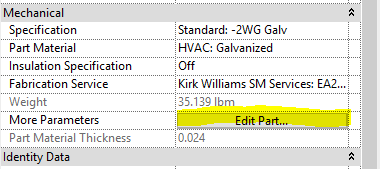

Is it possible to access the values within the “More Parameters” parameter that deals with fabrication parts in Revit through Dynamo 2.0?It is a button that executes a pop up window with the title of “Edit Part…” Although I do not have a vast knowledge of coding, I have a co worker that can understand and write code, so the more detail the better. The image below shows what I mean.
MoreParameterspic

Not sure it’s accessible, but the content here will let you and your co-worker get a start on finding out.
Thank you. Yes, I was able to find the dimensions with the fabrication packages! I appreciate your help
