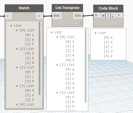

Another option. If you transpose the list first you can get the sublist you want with a codeblock:
