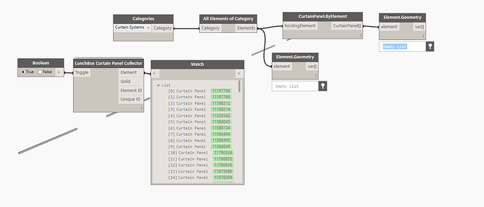

any reason i wound’t be getting the host panel?
@Jeremy_Luebker2 Here’s what I was thinking.
That worked beautifully thank you!

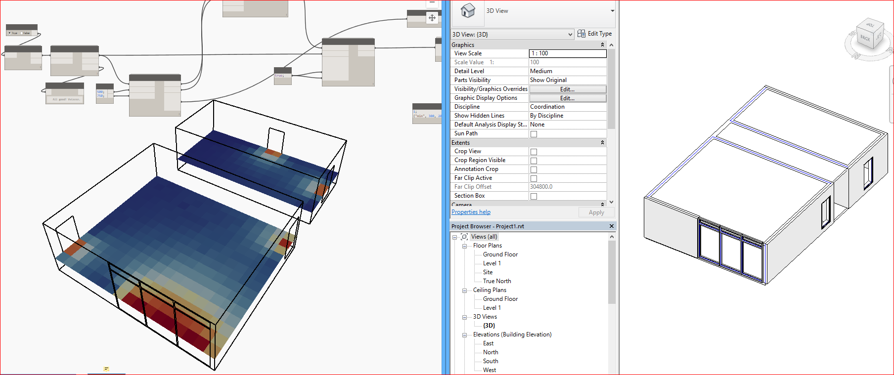

i might have simplified the explanation too much. im actually trying to split the simple bounding box shape out of the room. this is pretty much the same thing the honeybee does in grasshopper. trying to run an energy model on a revit project
What about this solution. Try honeybee for Dynamo!

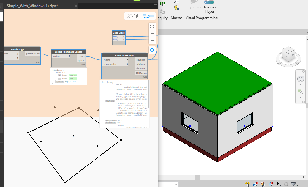

Hi. I’m using Honeybee in Dynamo to analyse daylight now . I have met trouble with collect rooms and spaces node like shown in the pic. Could you plz share me with the dyn code you used for this trial? Thank you so much:)
