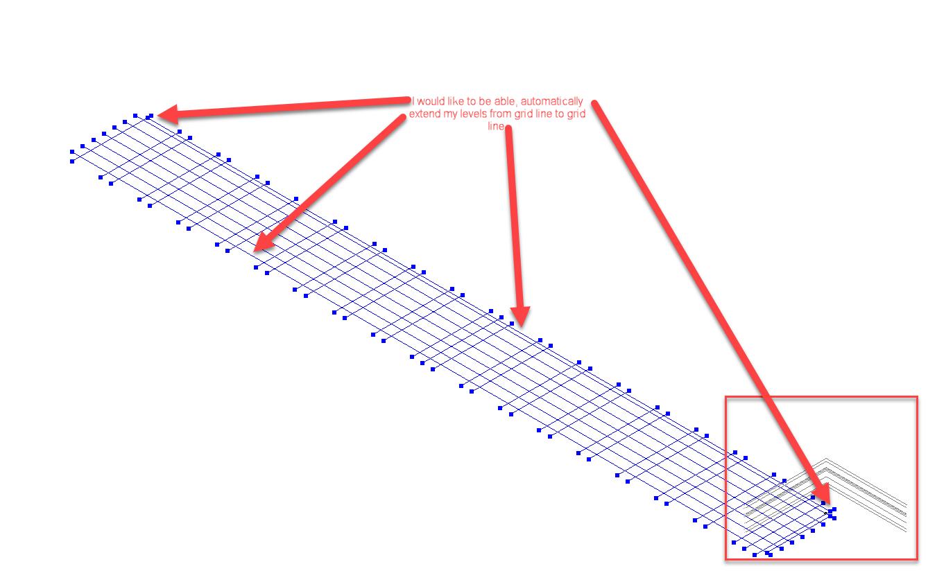

I am working on series of the routines to automatically generate levels, grids and zones from excel dashboard. So far I have I manage to make it work, however I still have few quirks that I am trying to work out.
I would like to be able to automatically stretch my level to my first and last grid lines, can anyone think of a tip, advice or a solution. I know i can do it manually but would like to overcome this step.

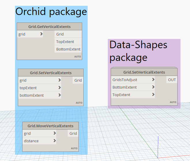

Hi all,
Maybe @Mostafa_El_Ayoubi or @erfajo is interested to add a βLevel.SetHorizontalExtentsβ (by boundingbox) node to their package. I donβt know if the API would support this function, but it would be a nice addition to the nodes below.
