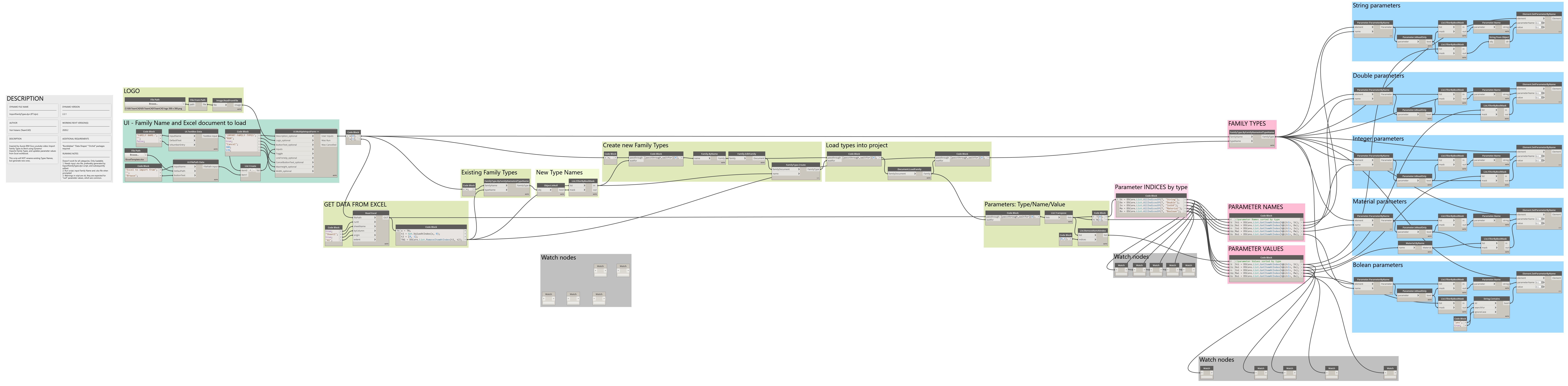

The two scripts Export and Import Revit Family Types of a given Family to and form Excel.
Thanks to Aussie BIM Guru for the inspirational videos that cover a good portion of the scripts.
I took a different aproach with the Import script.
ExportFamilyTypes.dyn (215.2 KB) ImportFamilyTypes.dyn (177.1 KB)
ExcelTemplate.xlsx (9.3 KB)
EXPORT
IMPORT
