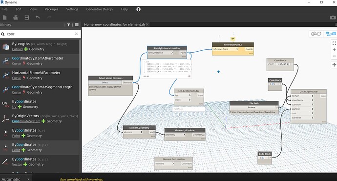

I need help on correct the file on exporting points in excel for a particular family. I have so far worked on gettings points for the family however, need to transform that into data to export in excel.
Kindly review the image and assist.

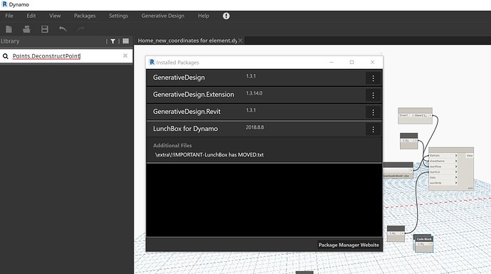

I have installed Lunchbox, after installation should I search on the left side to find Points.DeconstructPoint.
No need for lunchbox or wombat here.

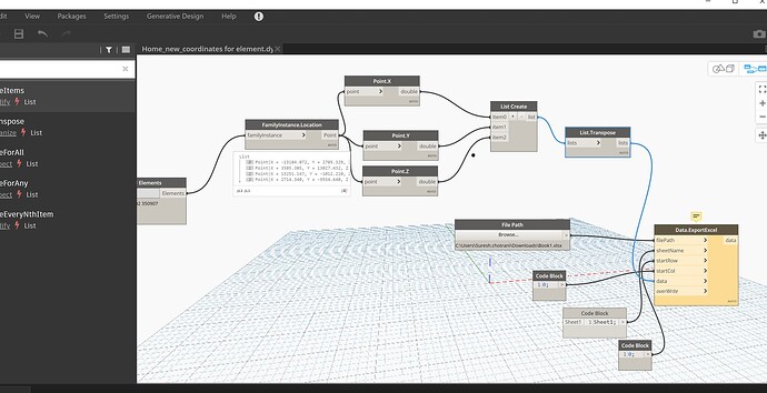

Point.X, Point.Y, and Point.Z nodes will return the values you need.
From there it’s a matter of List.Create, List.Transpose, and export to excel.
Alternatively [pnt.X, pnt.Y, pnt.Z] in a code block will generate the list you need.

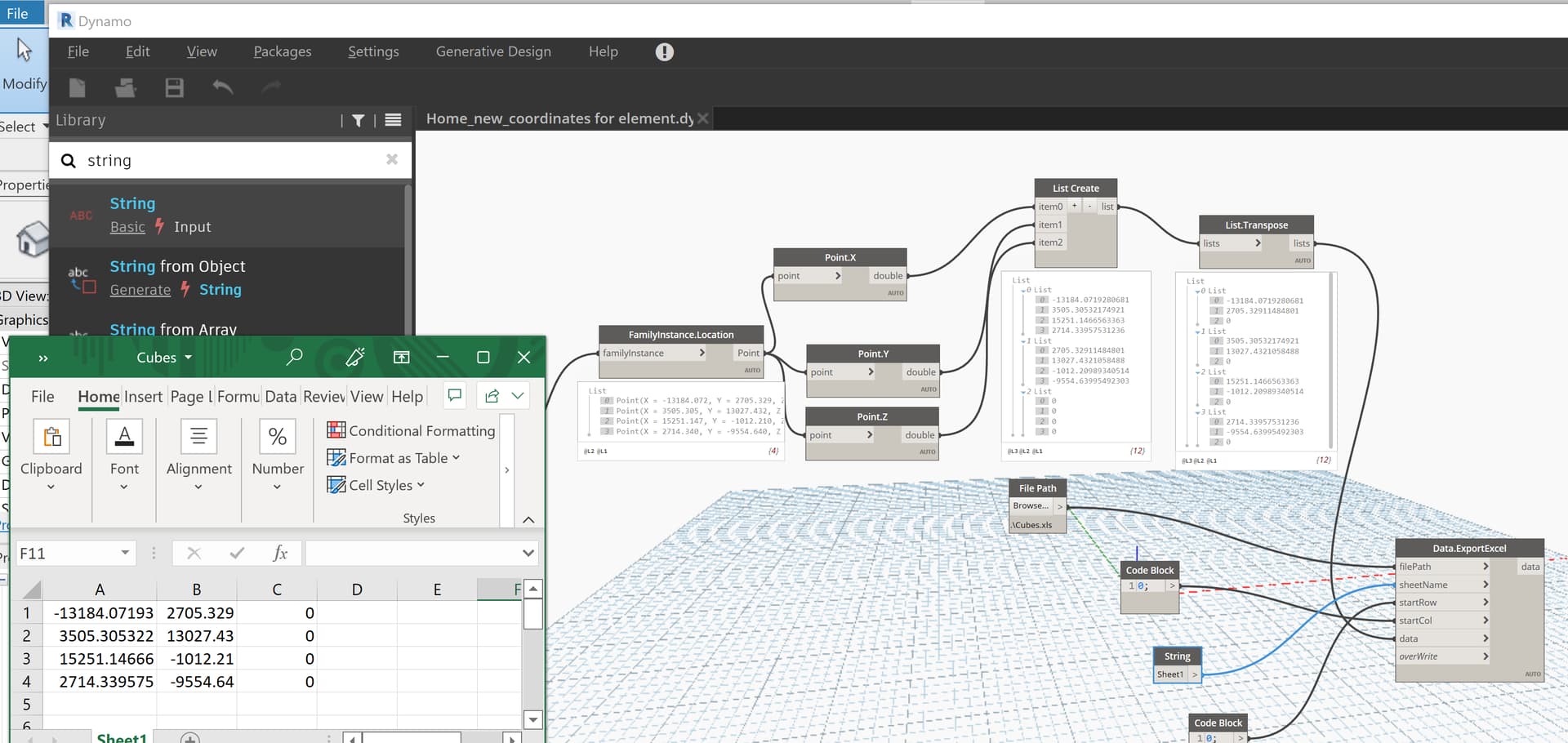

Kindly review
You aren’t providing a sheet name, but a function. use a string node to type Sheet1 or edit the code block to be "Sheet1" and you should be all set.
And there we have a solution. :slight_smile:
