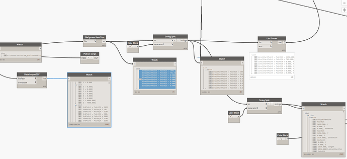

i have written a list of lines to a csv file and now try to read them again
it looks like i get the data in… but it is in text format.
splitting it and putting it all together will be a big pain in the @$$.
need something like string.to.line node or a different way to export.
