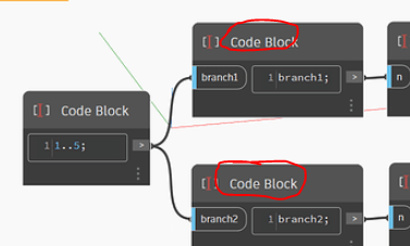

P13
The code is looking for the node name. You have to rename your nodes to match the names you’re checking against.
@Nick_Boyts, Yes it works, thank you very much
