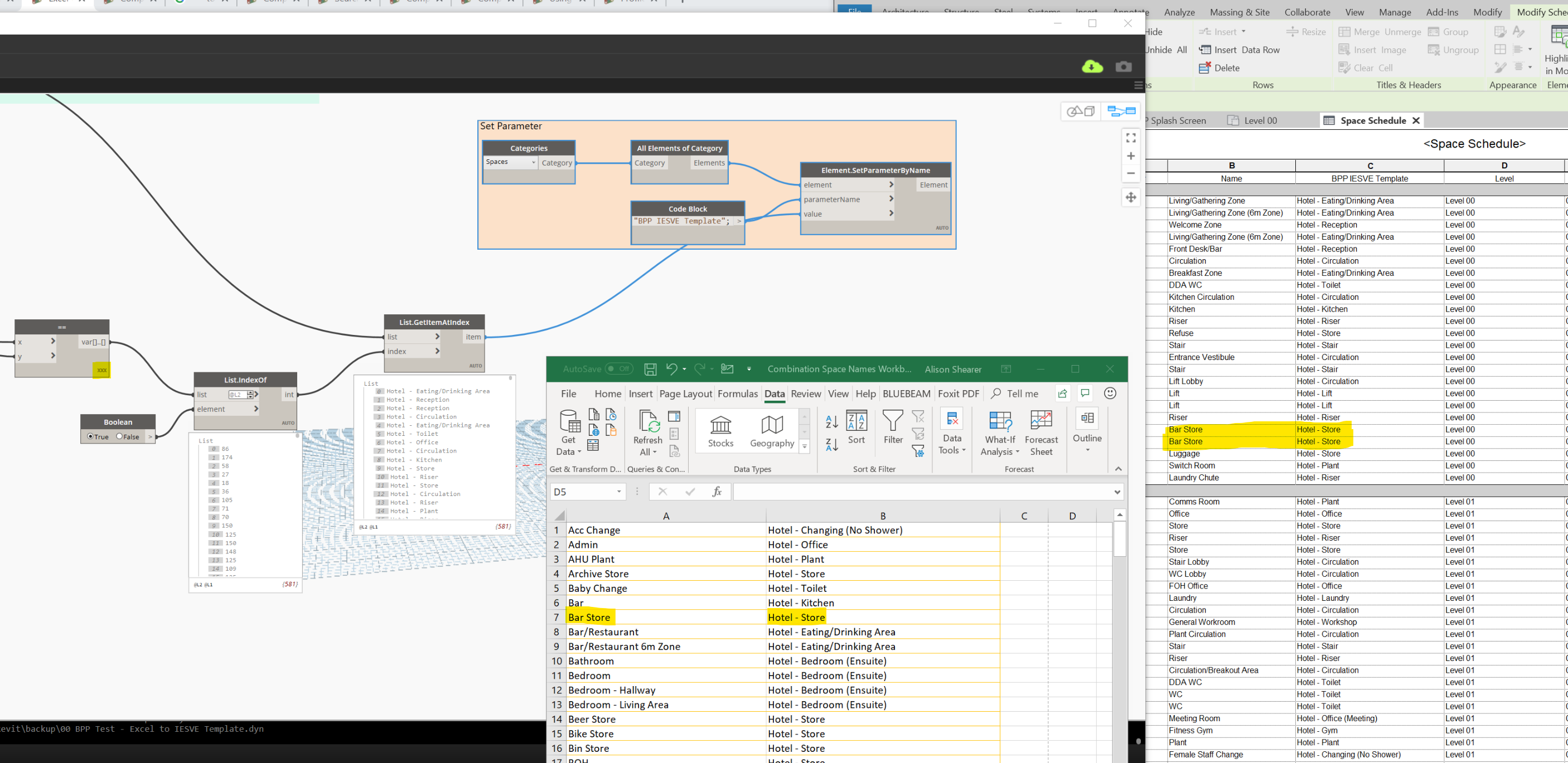

The Goal: Have Dynamo read a spreadsheet & if the space name matches a Revit space then write the corresponding template to a “BPP IESVE Template” parameter.

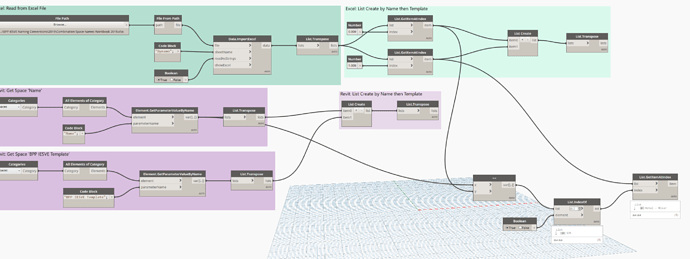

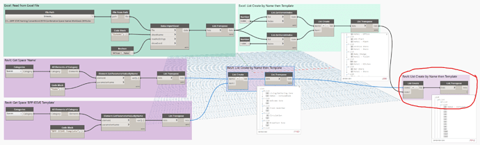

This is my starting code (I know the red section is totally wrong, I got a bit mad at my inability to make it work and deleted all my other nodes):

If all you want to do is compare the 0 index of spaces to the 0 index of the excel import, and when ==, replace 1 index of space with 1 index of excel import, that isn’t too hard and we can help you.
Something like this:

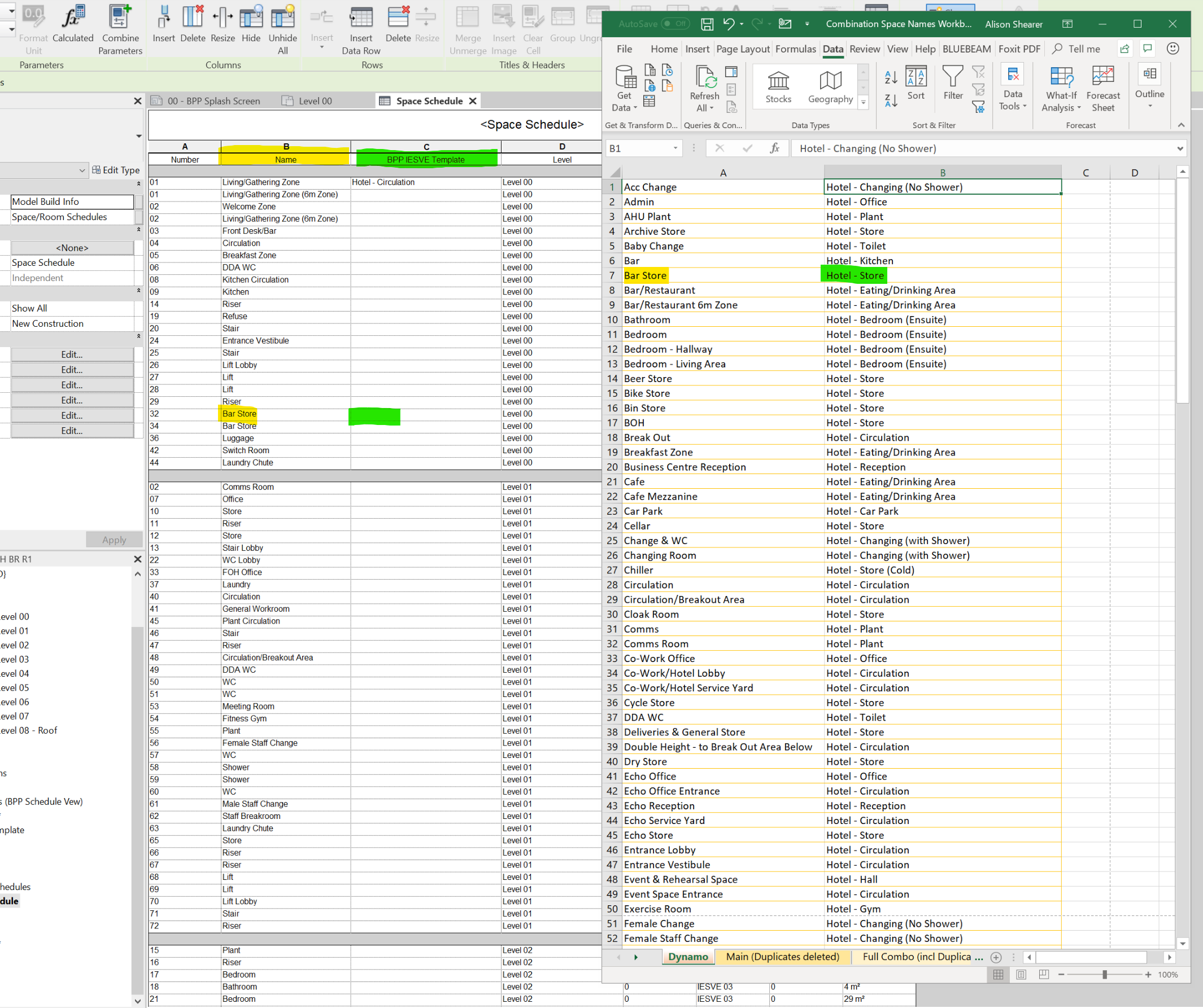

Basically I have a spreadsheet consisting of various space names and the templates they should have assigned (the current model I’m testing this Dynamo with doesn’t contain all these space names). So in the case of ‘Bar Store’ I want the BPP IESVE Template parameter to read ‘Hotel - Store’ in every instance created in my model.
Thank you for the example! I was playing about with the == node briefly yesterday but made no headway. Just a quick trial at your suggestion gave me ‘Hotel - Riser’, that’s progress in my book!
Can you show the outputs of the getparametervaluebyname for space name? Sounds like a lacing/levels issue.
Also the == is set to cross product for lacing. You can get that by right clicking the node and going to “lacing”
That’s it! It was the auto lacing that was throwing it off, set to cross lacing it works perfect. I tried cross lacing yesterday, but with a different list approach (that didn’t work), so it was more of a stab-in-the-dark than an informed experiment.
