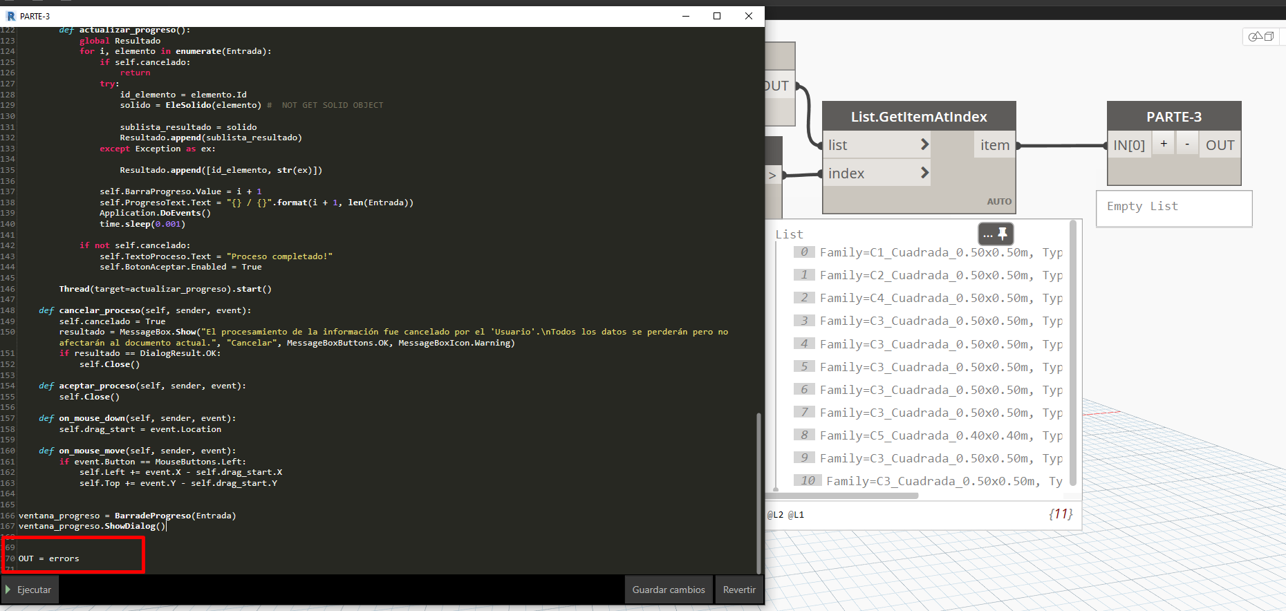

Could you please take a look at the general code, maybe I am finding some conflict or library that I am not referencing correctly…??
what are the errors ?
OUT = errors
Here OUT = errors
try to replace
if isinstance(g, Solid) and g.Volume > 0:
by
if isinstance(g, DB.Solid) and g.Volume > 0:
Wow… Thank you, I appreciate your response if the function worked.
Could you please tell me why in this case it is necessary to add the “DB” I mention it because in other codes the function does not require the “DB” and it works very well. Without your help I was about to look for a bridge to jump off of… thank you
@AM3D.BIM.STUDIO Different libraries might have functions or classes with the same name. Using the full namespace avoids ambiguity and ensures that the correct function or class is being used.
