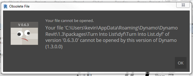

I worked on a file last week and tried to open it this morning and this is what it says:
I imagine I have an old package loaded that it can’t open. How do I troubleshoot this to open the file and get rid of it?

Remove the Turn Into List package from AppData location. Clockwork 1.x.x includes this node. The problem is you may have downloaded a package that had a dependency on the old version. Bakery is a major one that has this issue.
Thanks John. That was perfect.
