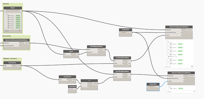

As you can see from the picture, I have a boolean list saying which room each element is in, and the corresponding name of the room in another list. I just can’t wrap my head around how I unfold the lists I have to put the correct value in an instance parameter of each element.
How do I continue from the three nodes you see in the picture to put the name of the room an element is in into an instance parameter on the element?

Thank you for your feedback, but I am unable to figure it out.

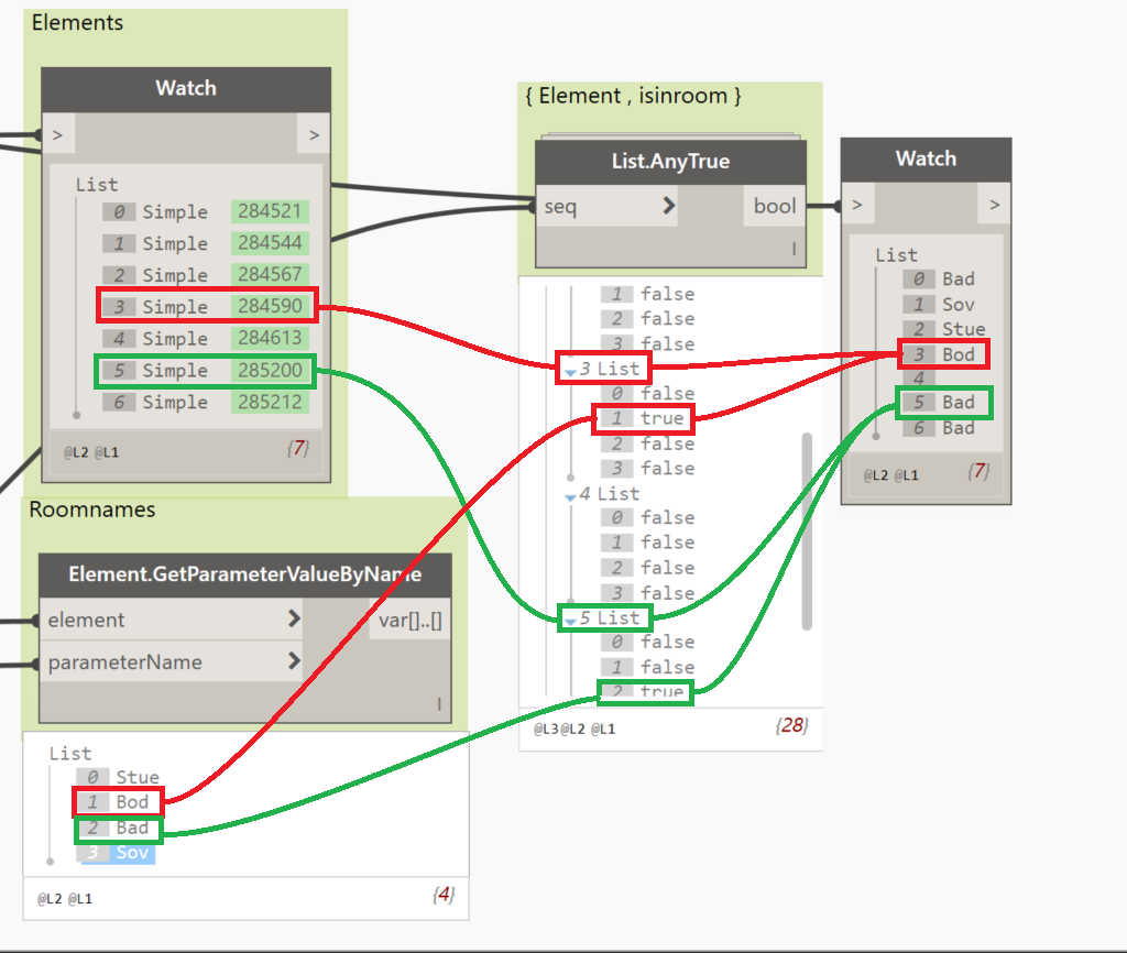

I would like to filter my lists to result in the right hand “Watch” node shown in the picture below.
Does anyone have an idea to how I can use the three left hand nodes in the picture to get the same result as shown in the right hand “Watch” node in the picture above?
I figured it out by accident :slight_smile:

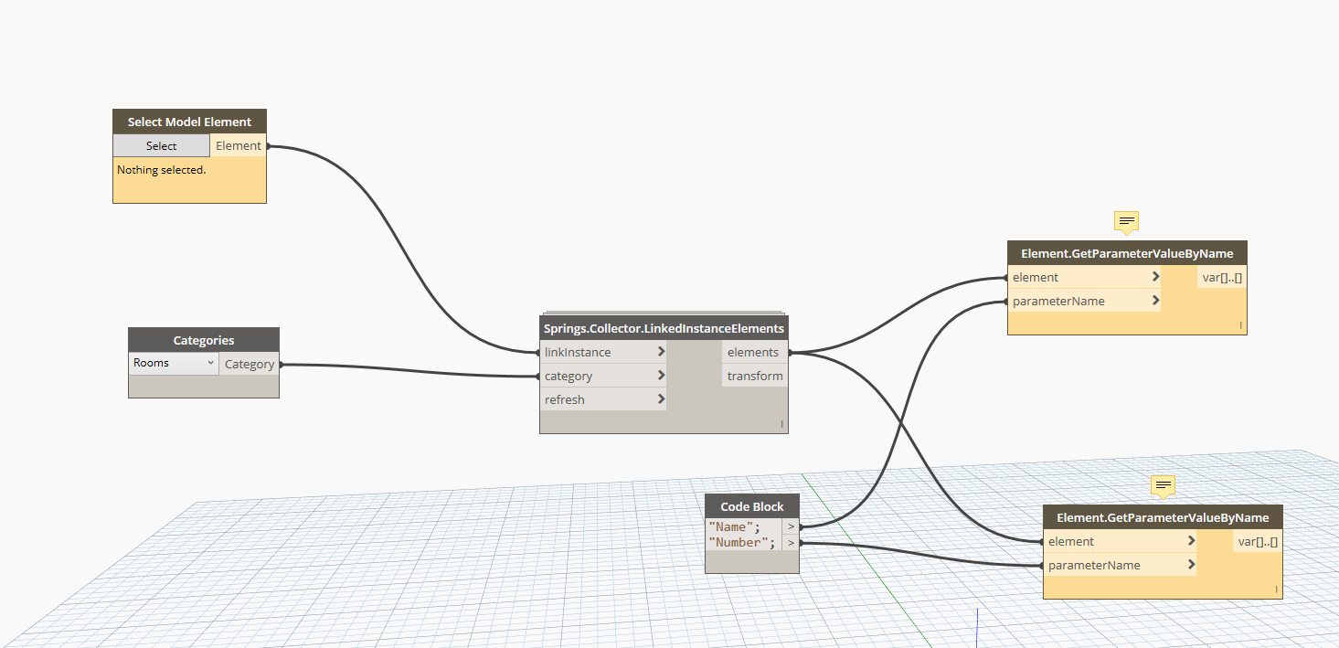

With the package “SpringNodes” you can get rooms from a linked model with these nodes:
With the “Select Model Element” Node, select the linked model that contains the room elements.
