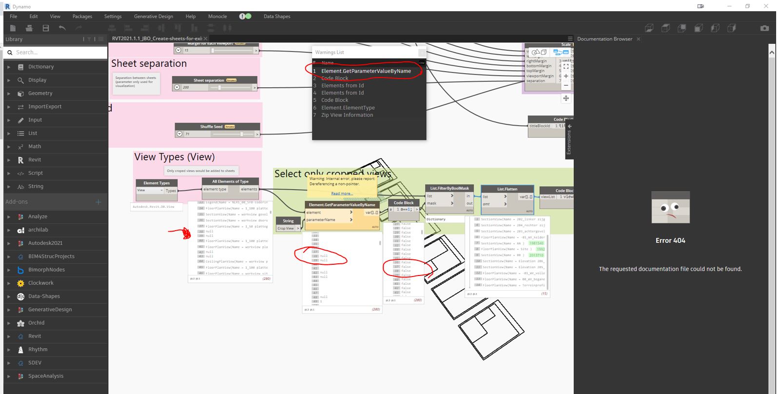

We get the following warning (see fig. 1).
Presumambly it is the “null” values?
Fig. 1
Does anyone have a solution for this?
Thanks in advance.

This fixes the above warning, but I get several warnings later in the script (didn’ have this before ; see fig. 1).
New warnings see fig. 1 and fig. 2.
In fig. 3 you see the previous error. Here you can also see that in the node "code block - viewlist (1) viewlist; " get different data as afther adding the “List.Clean”.
Fig. 1
Fig. 2
Fig. 3
Do you have a solution for this?
Thanks in advance.

You would have to filter the cleaned list, not the original one. Otherwise you’re not only ignoring the nulls, you’re also throwing off your list order.
@Nick_Boyts
I don’t quite understand what you mean.
If I do the filtering afterwards, I still have the warning?
Fig. 1
