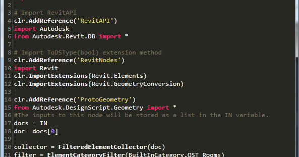

Hello everyone,
I’m getting new at Dynamo and here’s something I’m not sure how to solve :
I read this tutorial :
I tried the dynamo file with the revit test room but the first node was not Element.Document with only var. as exit but Element.Document and port 1 (in and out).
After looking, I bet this has to do with the same thing that goes here :
http://dynamobim.com/forums/topic/element-document-and-python-script-for-phases-in-dynamo-0-7-4/
“In Dynamo 0.7.3 this worked out fine. In 0.7.4 the Element.Document is not accepted anymore and when using the Current Document node, the Doc.Phases statement in my Python isn’t accepted anymore.”
I only manage to get the rooms category, and the Element.Name but I want to be able to search for the Service and Occupancy Parameter to get a list…
(Because when I try to connect the block “ROOM PARAMETER” (“Department”) to the ParameterName connection, that doesn’t work… )
Any suggestions here on how to get it ?
