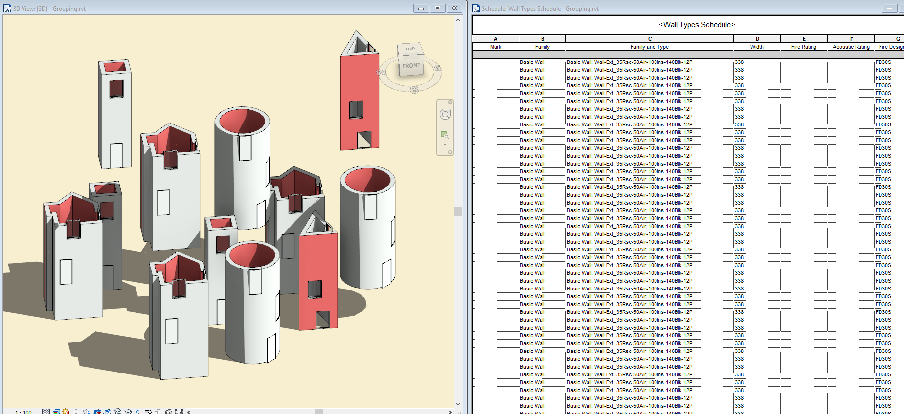

@Ewan_Opie thanks for getting it started…
Man that was painful… The problem as you know is the naming, you have to make the unique groups, swap them to that, make the changes, swap them to a single new group, delete the original group, create a new group with the old group name and dump them back on there… I’m sure someone can clean it up using functions. It’s like that game…
This works for me, hopefully it works for you…
Cheers,
Mark
