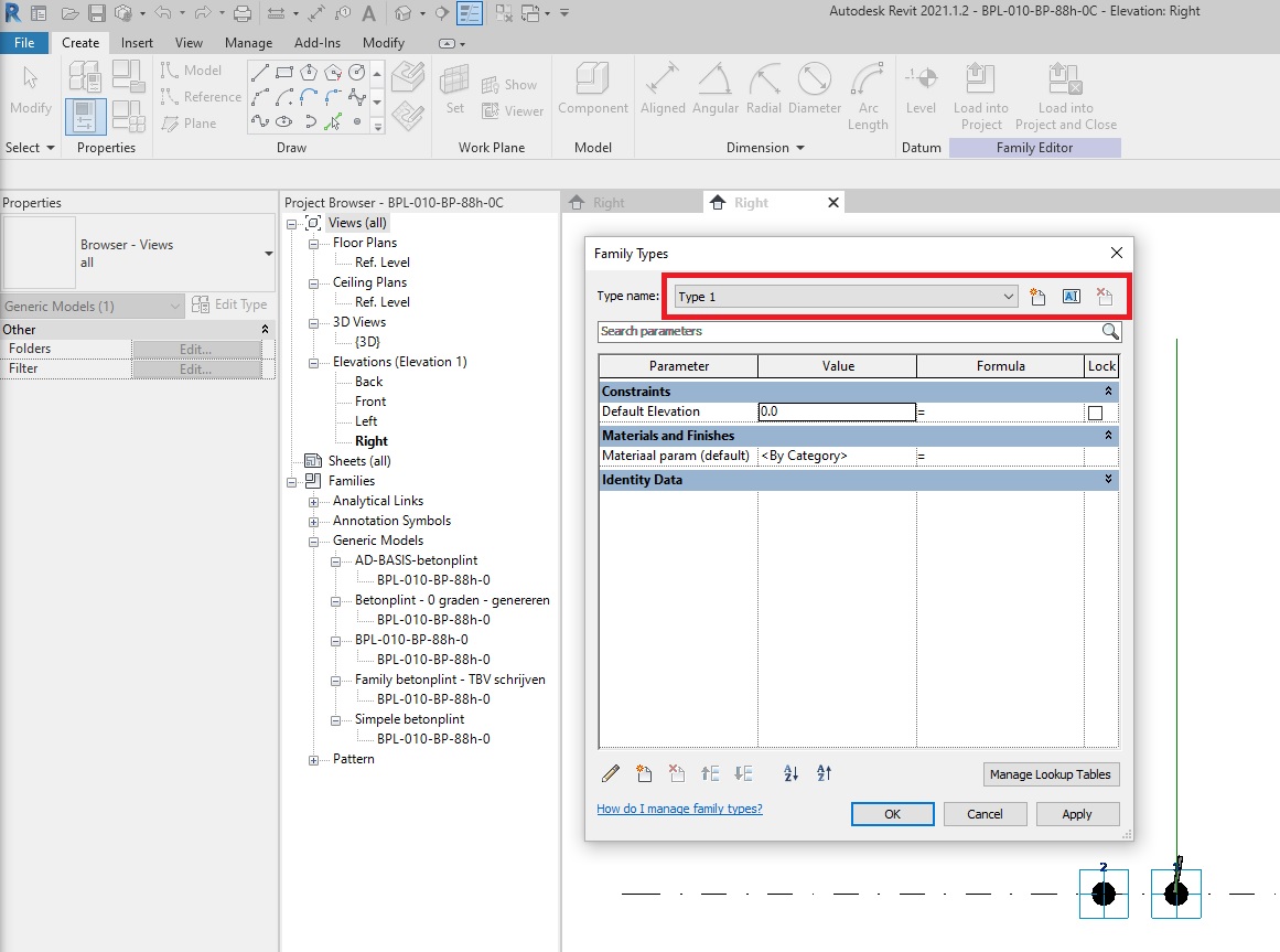

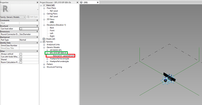

Objective/workflow: in our company we are using a base parametric family(called: Betonplint - parametrisch), which is loaded in to a adaptive family, which is loaded in to a secondary adaptive main family. so we have a dynamo script that generates and saves these families with dimensions from an excel sheet. and later on this generated families will be loaded in to a project and with an other dynamo script we place these adaptive families in ‘the world’ with coordinates. when that model i generated we are using ‘Navisworks Manage’ to share our model with our client. but due the fact we are using 1 base family, all families wil return with there base name in Navisworks manage. See screenshot below:
Selection tree navisworks manage
But see this picture how we want to present the navisworks tree:
Selection tree navisworks manage we want
i achieved this by renaming the family with this method and by renaming it’s type with this method.

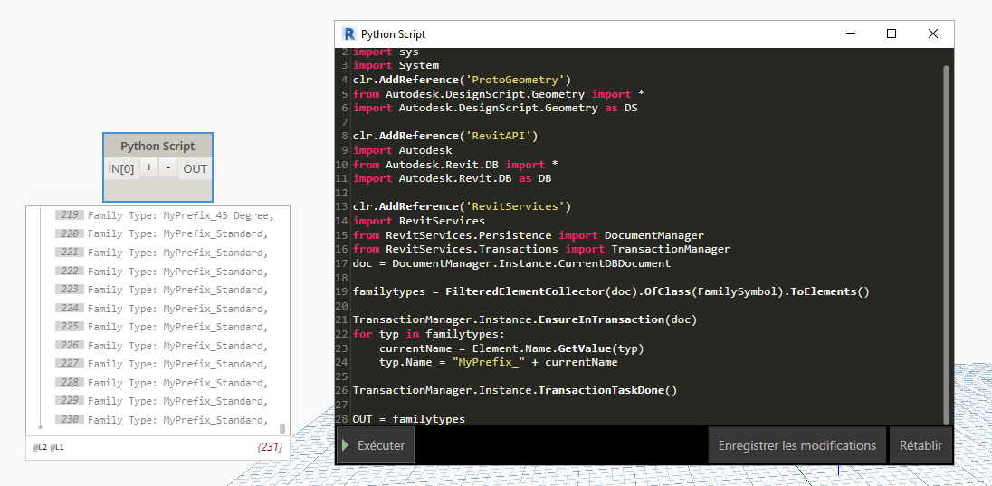

To rename family types you should use the ALL_MODEL_TYPE_NAME builtin parameter.

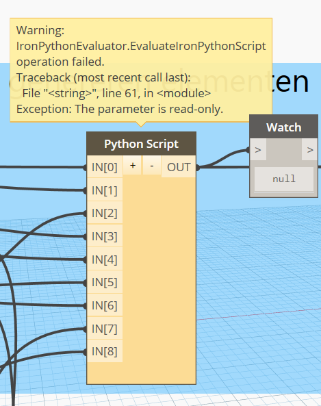

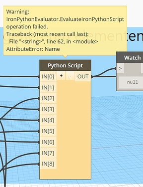

@Daniel_Woodcock1
i’m sorry, but i made a small mistake in my code so the if statement did not do anything at all.
i fixed my if statement. and tried 2 different ways of renaming the parameter.
1- when using typename.Set (as suggested i get this error). Quite logic in my opinion
2- when using typ.Name(BuiltInParameter.ALL_MODEL_TYPE_NAME).Set(renameb[0])
i get this error.

You are still doing this wrong. Can you replace the part I quoted with the code I provided as your code is still pretty much as it was when you originally posted.
To break this down a little further…
For the first error, you are using the readonly BIP SYMBOL_NAME_PARAM and not the editable BIP. This needs to be ALL_MODEL_TYPE_NAME if you wish to set it.
For the second error, you are doing typ.Name(Builtin… ). This simply is not a thing, FamilySymbol.Name is a readonly property and should always be without brackets and never assigned to. Instead, you need to get the parameter object (ALL_MODEL_TYPE_NAME) first, you can get and set this. Again, see my last post, I am not setting the name property on the type, instead I am setting the parameter objects value on that type which in turn updates rhe readonly FamilySymbol.Name property.

Hmm, seems to be that one or more of your family types cannot be renamed. You might want to add to your if condition a check if the family type can actually be renamed or parameter is readonly. Use one of the following…
typ.CanBeRenamed
Or…
typenameget.IsReadOnly
So your if statement would be along the lines of…
if seachb[0] == typnaam and typ.CanBeRenamed:
Or…
if seachb[0] == typnaam and not typenameget.IsReadOnly:
It is always good to add validation where you can to catch conditions like this. If I were you I would do some tests in another node isolating the type renaming so you can see better what is happening, or in the same node, if it is read only parameter or type cannot be renamed then add type to an array you can output in the graph so you can see on what elements this is happening to. This is the best and only way to debug in dynamo python.
Hello
you can try to use directly the Name property (setter)
import sys
import System
import Autodesk.DesignScript.Geometry as DS
clr.AddReference('RevitAPI')
import Autodesk
import RevitServices
familytypes = FilteredElementCollector(doc).OfClass(FamilySymbol).ToElements()
for typ in familytypes:
	currentName = Element.Name.GetValue(typ)
	typ.Name = "MyPrefix_" + currentName
OUT = familytypes
@c.poupin thanks for your reply. it works now.

The problem i have now is that in the top family still ‘type 1’ is. and i wand tot change is. but cant really figure out what i need to add to find this ‘type 1’.
See the picture below, the type 1 is changed in all lower family’s but not in the top one.

To rename types in the family editor, the method is as follows
https://www.revitapidocs.com/2021.1/ddd98706-5a07-feac-4b1f-49d52471a8c8.htm
Note
it might be better to do one script per environment (project and family editor)
