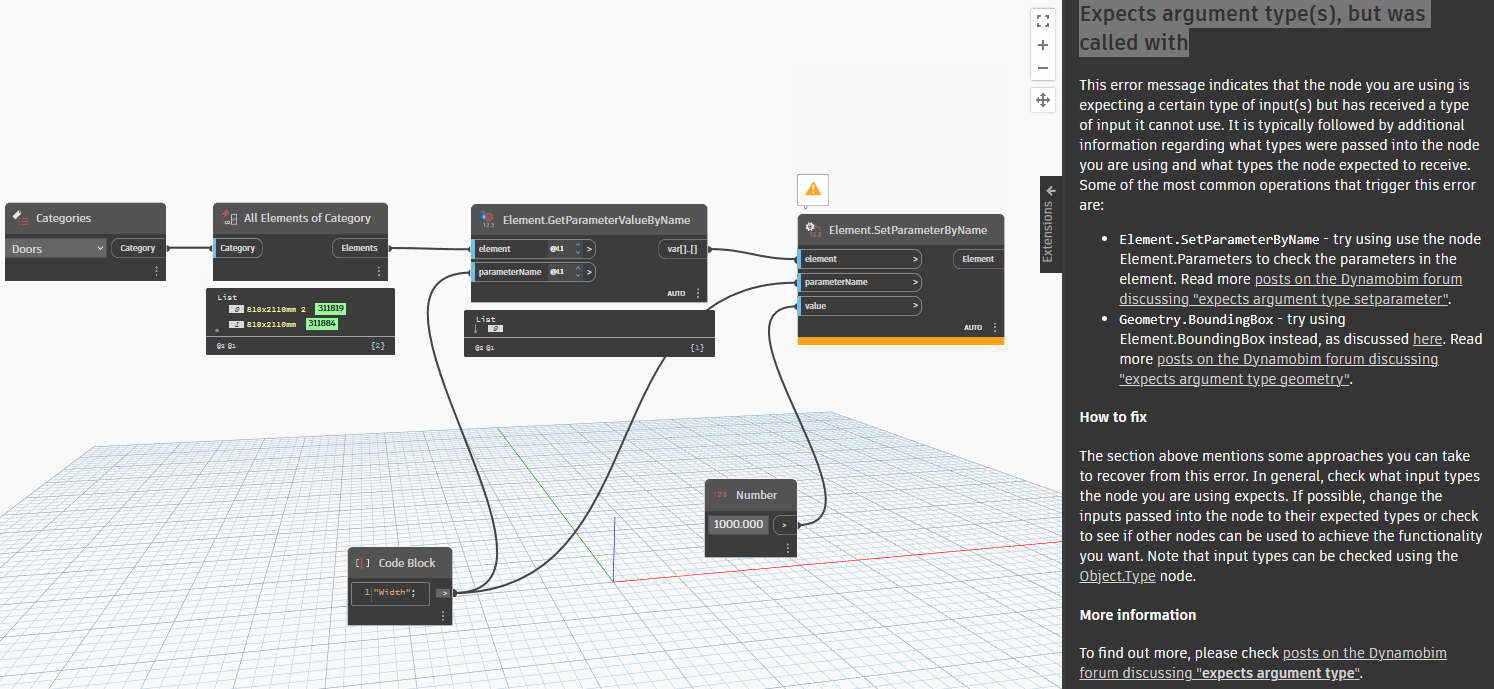

Hi Guys, I am stuck how to resolve this script on how I can change the door width size. please help. Thanks in advance

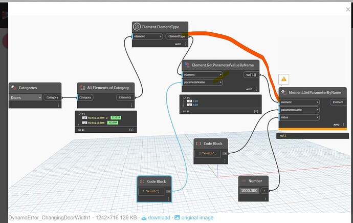

Hello and welcome :wink: i belive you need element.element.type node, before your get.parameter node…assume the width parameter is type parameter
Hi, thank you, appreciated :slight_smile:
I still got error :joy:
I am just new learning this. Appreciate all the help I can get :slight_smile:
The get parameter node is returning value from the width parameter. To set the parameter you will need to take the output from the element.elementtype node and push that directly into the set parameter node. You don’t need the get parameter node at all.
