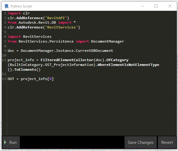

This should return a list of Project Information elements:
project_info = FilteredElementCollector(doc).OfCategory(BuiltInCategory.OST_ProjectInformation).WhereElementIsNotElementType().ToElements()
Hey Tom!
I am unfortunately still getting an error with the input provided. Please see the below. Thank you for all your help.
Create a Python Script node with no inputs:
Thank you so much Tom! Huge Help :slight_smile:
hello!
I was looking for a similar issue and found this post.
I tried to tweak the code so it shows Reference Plane but getting an error
clr.AddReference(‘RevitAPI’)
clr.AddReference(‘RevitServices’)
import RevitServices
reference_plane = FilteredElementCollector(doc).OfCategory(BuiltInCategory.OST_ReferencePlane).WhereElementIsNotElementType().ToElements()
OUT = project_info[0]
could you let me know what the problem is if you got a moment please?
I appreciate it!
