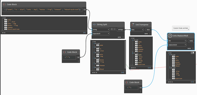

Sadly i have no idea which Node could help me to get from “Input” the “Output1” and “Output2”.
Please note that the indices are always the same and that the “Output2” has indices those are empty.

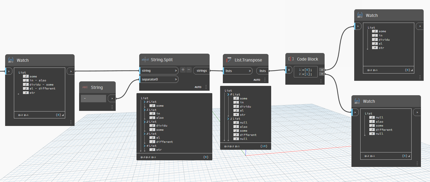

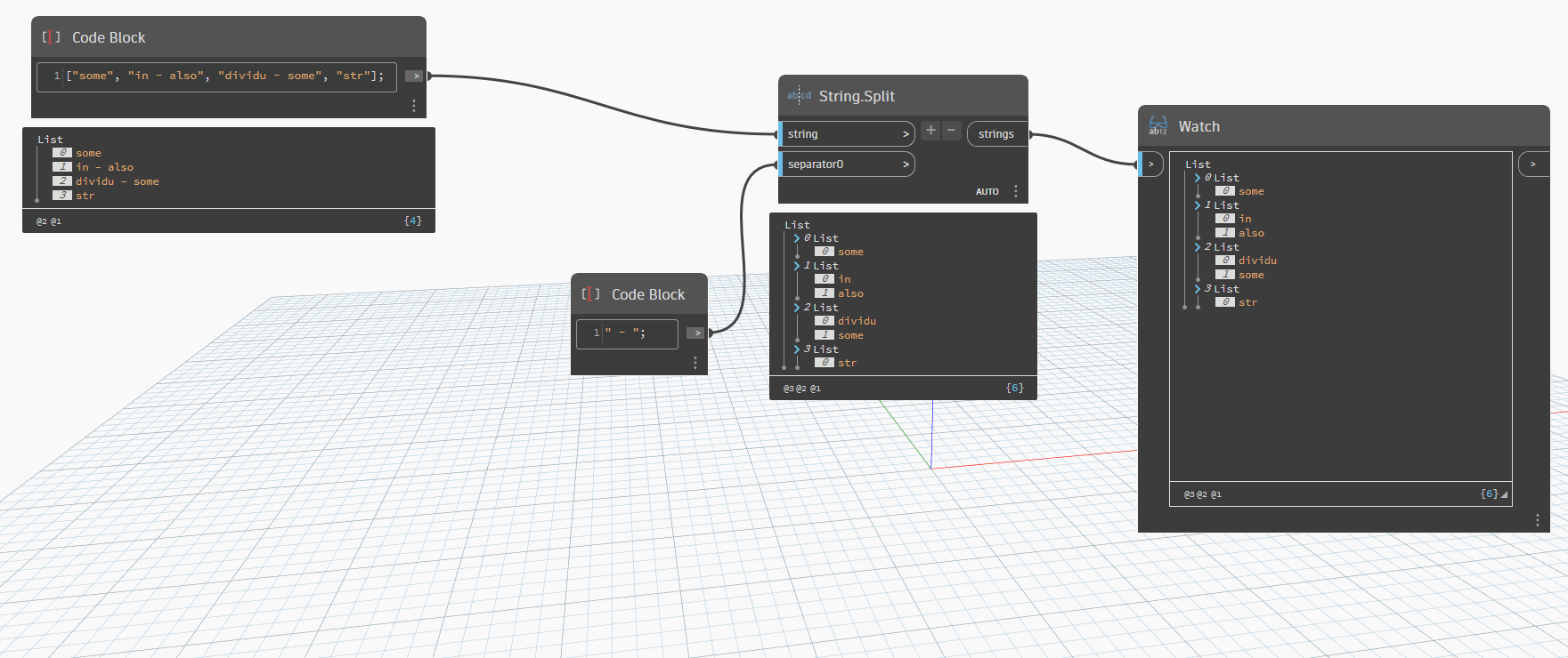

Hi!
You can use string.split for this
I realised this was half a solution…

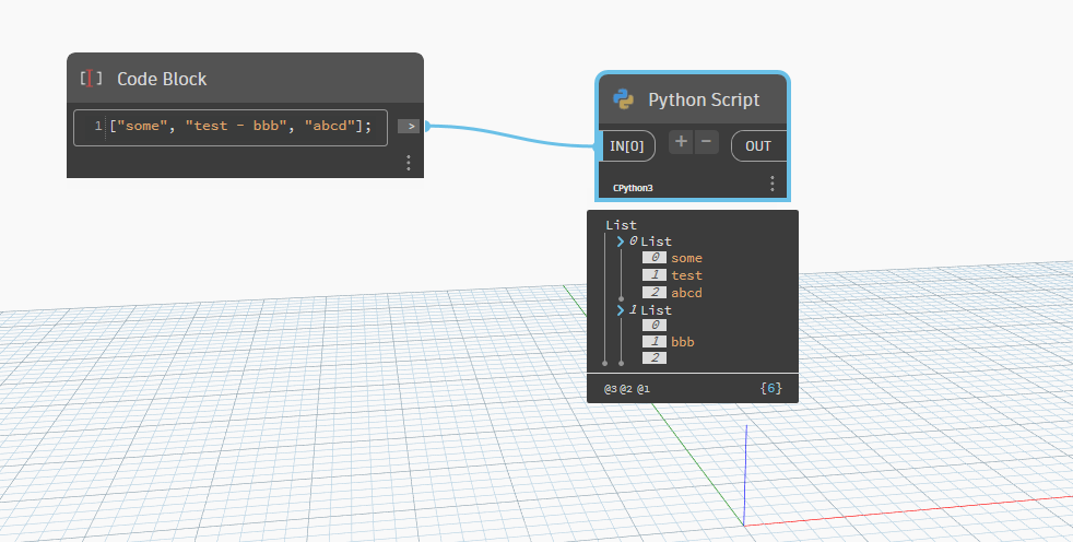

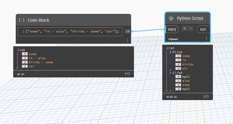

To keep your lists structure maybe just use this python code:
import sys
input_list = IN[0]
list_one = []
list_two = []
for item in input_list:
    parts = item.split(" - ")
    list_one.append(parts[0] if len(parts) > 1 else item)
    list_two.append(parts[1] if len(parts) > 1 else None)
OUT = (list_one, list_two)
This should do the trick:
you can clean the nulls of the second output
Wow. It worked.

Hi, Thanks a lot, It works also perfecty!
Sadly I can mark only one solution and Python is always more elegant:)

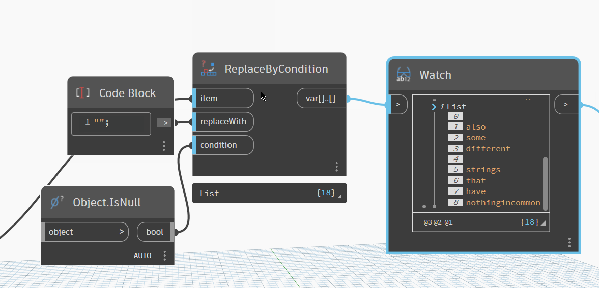

Sadly i have problem with an archilab package.
I’ve used ReplaceByCondition instead.
