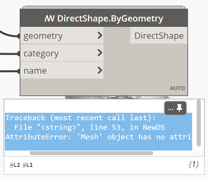

So… I’m importing a obj mesh, so I can push it into a conceptual mass. But I don’t know why DirectShape.ByGeometry node do not work.
Warning: DirectShape.ByGeometry expects argument type(s) (Geometry, Category, Material, string), but was called with (Autodesk.DesignScript.Geometry.Mesh[], Revit.Elements.Category, Revit.Elements.Material, string).

Mesh doesn’t inherit from Dynamo’s ProtoGeometry Geometry base class, so its an invalid input. You’ll need to find a way of converting it to one of the entity types you see OOTB under Dynamo’s Geometry node library.

Try DirectShape.ByMesh again but you’ll need to be able to convert the mesh from MeshToolkit to a Dynamo mesh (under its geometry node library). Failing that, give that Spring node in the video a shot and you should get a result.
This sequence almost did the trick. No yellow balloon on top of the node…
But got this at the end:
Now worked. I used information to put another mesh together just to input into DirectShape.ByMesh node.

Basically avoid connecting a mesh obtained from the Mesh Toolkit notes to the input of the OOTB Mesh nodes
Instead obtain Vertices (points) and Indices (integers) and recreate the mesh.
Confusing, but once you’re able to distinguish the nodes it should be a little less trouble.

i have tried this script but i got some errors
I have trued first this script i could have the mesh on Dynamo but into revit always have a problem with direct shape by mesh
