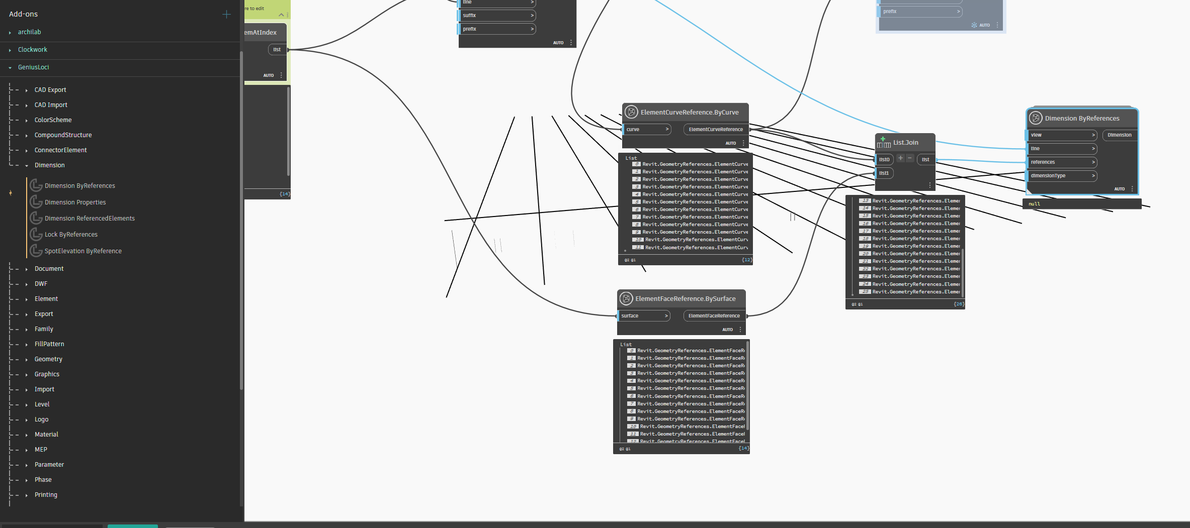

I keep facing this issue when I use Genius Loci, it keeps showing me null.
Is there any issue with the types of inputs ?
arhh i see, genius loci expect autodesk.db.reference, and not revit reference, you can get these reference with genius loci as well, many nodes for reference
could be an issue with obj types, like sovitek suggested.
