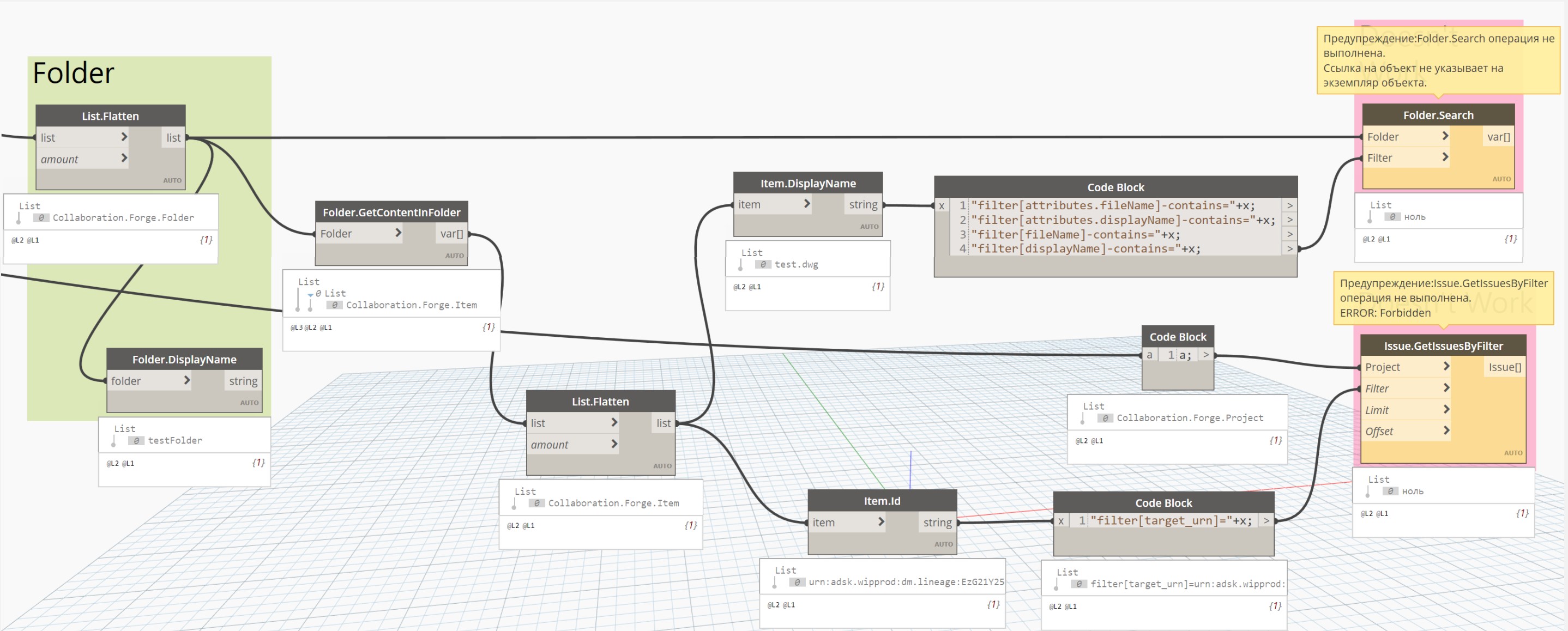

I am trying to reproduce the examples shown in the post - https://forum.dynamobim.com/t/civil-3d-toolkit-feedback-thread/43570/3
What I have already done:
- created a Forge application with all API checked
- In the BIM360 added custom application integration with maximal access rights.
- my account also with account and project admin rights
- In the script I got the hub, the projects, selected the project, selected the folder, and found the item in the folder.
But I can’t:
- find the file in the folder using the Folder.Search node
- get the issue using the Issue.GetIssuesByFilter node
Which way should I dig and what should I check?
