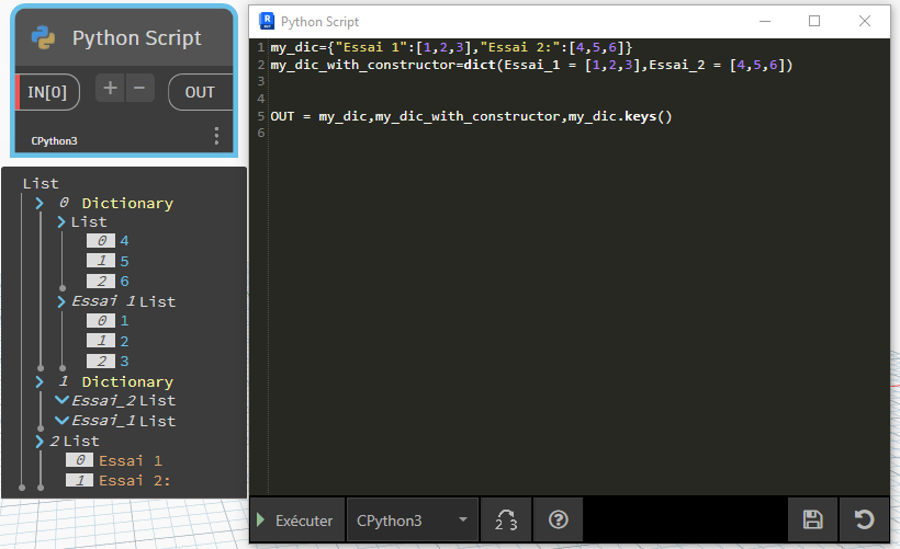

Dictionary with python (character not accepted?)
Why there is a display problem when using the : as part of a text string
I don’t see an answer on w3schools
my_dic={"Essai 1":[1,2,3],"Essai 2:":[4,5,6]}
my_dic_with_constructor=dict(Essai_1 = [1,2,3],Essai_2 = [4,5,6])
OUT = my_dic,my_dic_with_constructor,my_dic.keys()

my_dic={"Essai 1:":[1,2,3],"Essai 2:":[4,5,6]}

Hi, I don’t know, that’s what I’m asking (if you use a : in your key it doesn’t show up but you can use them anyway)

your dictionary is correct, It’s a bug of the out DynamoWrapper (Dynamo convert python dictionary to Dynamo Net Dictionary at output Python Node)
you can print yours dictionary to check it

The bug appears to be with dictionaries with a : in them.
Submitted as a bug here: Dictionaries fail when there is a : in the key. · Issue #13777 · DynamoDS/Dynamo (github.com)
