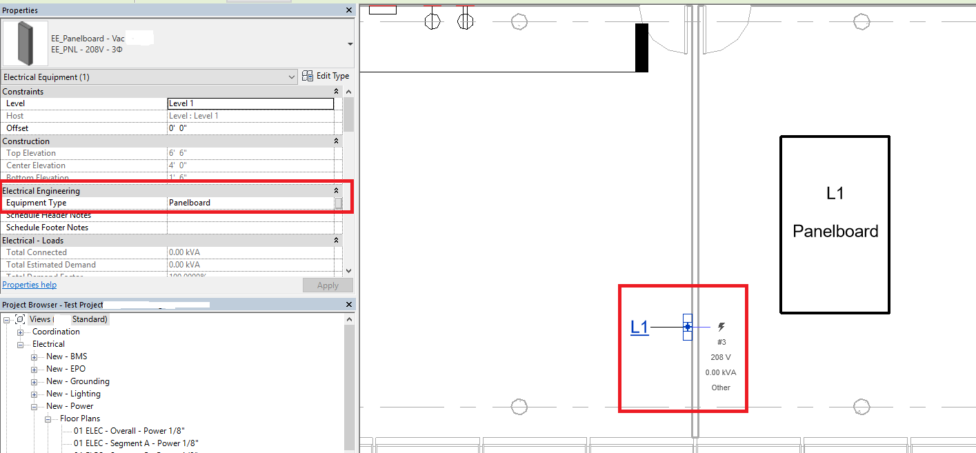

I have two families, Detail Item and Electrical Equipment. The Detail Item has two parameters called “Detail Name” and “Detail Equipment Type”. The Electrical Equipment has also two parameters called “Panel Name” and “Equipment Type”. Is there a way to assign the value from “Detail Equipment Type” into “Equipment Type” only if “Detail Name” and “Panel Name” have the same value?
Thank you in advance!

Here is the detail item family I created as an example:
Detail - Panelboard - SLD.rfa (284 KB)
and here is the Electrical Equipment Family:
EE_Panelboard - Vac (CCG).rfa (352 KB)

@Mark.Ackerley I made it work!!!
Thank you soooo much again!!!
